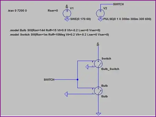

So armed with this info, we can simulate and prove the initial surge would be absolutely insignificant if we switched the bulb every 5 minutes. We don't really need to run the simulation for 2 hours to prove this, but we will. I have even extended the "warm up" time to 300ms.
Here's our SPICE circuit, the bulb is represented by a switch which gradually changes resistance from 9.5Ω to 144Ω over the control signal rise (300ms) The light switch is represented by another switch, which just changes from 1mΩ to 10MΩ
Bulb Test Circuit

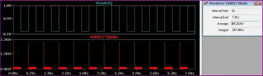

Here's the simulation, with the average power shown in the dialog box:
Bulb Test Simulation

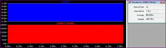

And now, here is a simulation with the bulb switched on for the whole time, with average power shown:
Bulb Test On
You can see that the average power is 95.659W, which is only slightly less than if we doubled the initial 5 minutes on, 5 minutes off test value of 48.2W (48.2" * 2 = 96.4W) so the difference the switching made is tiny.

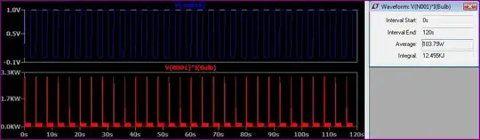

So, assuming the above, pretty fast, around once every 2 seconds according to the exaggerated simulation above (in reality, probably about once a second) Here's two minutes worth of switching once evry two seconds, and the average power is just over 100W (~104W):
Bulb Test Quick Switch
