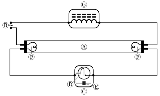

Fluorescent bulbs operate by a "starter" and "ballast" design. The filaments heat up more gradually since the starter (D in the diagram below) has to switch multiple times in order to kick-start the electrons flowing through the tube, not just one time like the incandescent light.
Basically, the starter (a bi-metallic switch) heats up and opens periodically, causing the magnetic field generated by the ballast (G) to collapse and release an inductive kick into the tube. If the kick isn't strong enough, there won't be enough electrons to sustain the circuit through the tube and the light will flicker. The light will only sustain when the magnetic field is strong when it collapses. For an animation of this, check out "How a Fluorescent Light Works".
