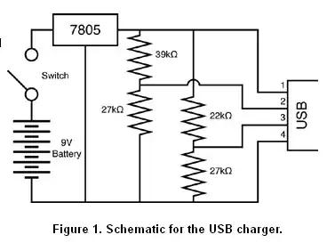

You could also make (below schematic) (or, sigh, buy) a USB charger that uses throw-away batteries in order to save your butt if the inspector inspects.
