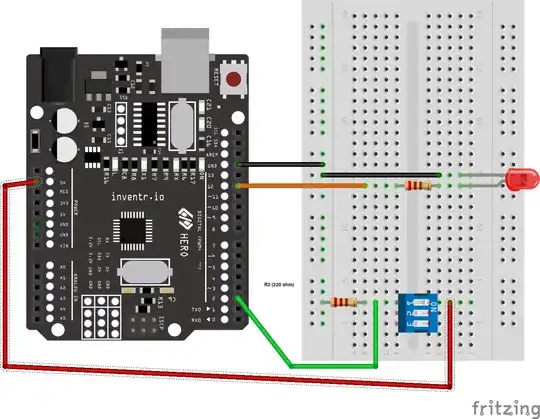

Here's the schematic:
Arduino and breadboard with LED and dip switch
The program is easy to understand. When digital input 2 receives input it lights the LED. The whole path with the LED makes sense to me, no need to discuss it. It's the path with the red wire and green wire going into the DIP switch.
My understanding is that the DIP switch is connected to both the digital input and the resistor and the resistor provides a path to ground for any stray voltage that gets induced on the wire by the environment.
What's confusing me is - isn't the digital input also a path to ground? If not, how does the circuit ever get closed? If there is stray voltage the resistor is providing a path to ground, but if the switch is closed then suddenly the digital input is the best path to ground?
When the switch is closed, the 5 volts can either go to the digital input or through the resistor and the resistor path has more impedance and so the 5V goes into the digital input. When the switch is open, why would any stray voltage not take the same path that the 5V takes?

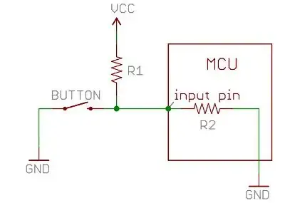

This image from (internal pull-down) shows a situation where the external resistor drives the pin up, since R1 << R2, and the button drives it down, since its resistance is almost zero:
Your illustration shows a configuration in which Vcc and GND are switched. If the input pin is configured as floating, you may consider that R2 is so large that practically no current will enter or exit the pin. Hence, any external resistance (R1 or the button) will determine the voltage at the pin.

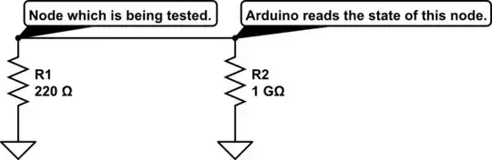

schematic
The above schematic is the illustration of how the Arduino is actually configured. Here, when the input is configured to INPUT state, the 1 GOhm impedance comes into action. Thus there is no path to ground through the digital pin.
How the circuit works then?
Well, this is pretty simple to understand with the concept of HIGH IMPEDANCE state of input pin. When the dip switch is off, there is no current flowing through the 220Ohm resistor. Thus there is no voltage drop across it meaning the node you are checking at has the same potential as the ground.
When the dip switch is on, there is path for the current to flow throught the resistor. Since the input impedance is very high, the current takes the path of 220 Ohm resistor. Now, the node you are checking is at +5V. (I am assuming your red wire is supplying +5V.)

  • I am sorry for bad schematic before. Now, I have edited it. See if you can understand it. – G-aura-V Mar 26 '21 at 15:29
  • So based on your answer and Justme's answer, it sounds if the switch is closed the current is always going to flow through the resistor and go to ground. That makes sense to me. The input is much higher resistance than my 220 so the current will always take that path. But if no current flows into the Arduino input, what is the input detecting? – Kevin Thompson Mar 26 '21 at 15:36
  • When the dip switch is open it makes sense that voltage and current are (effectively) zero at the Arduino input. When the switch is closed, the current goes through the resistor and out to ground. So current and voltage are present at the resistor, not the Arduino input. What would cause either the voltage or current to change at the Arduino input? – Kevin Thompson Mar 26 '21 at 15:38
  • There is very little current flowing through the high impedance resistor. I=V/R. Plugging in V=5V and R=1GOhm, I= 5nA. The red wire supplies the current required by both resistive paths. The total current through red wire is 5nA + (5V/220). – G-aura-V Mar 26 '21 at 15:38
  • Excuse this very simple question - when the 5v is applied to the circuit does that 5v apply to the whole circuit even though the current will take a single path? When the dip switch in my example is closed do both the 220 resistor and the Arduino input get 5v even though the current flows through the resistor? – Kevin Thompson Mar 26 '21 at 15:46
  • Learning starts with understanding what you don't understand. Questions are always welcome. The current doesn't take single path. Current flows through both resistors. How much current depends upon the resistor value (Ohm's Law). When your dip switch is closed, it acts like a piece of wire thus connecting the node you are checking and the red wire. – G-aura-V Mar 26 '21 at 15:50
