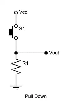

This question is asking the same thing, How does the pull down resistor work in this circuit?, and this one, Understanding pull down resistor current flow, and this one, How does a pull-down prevent a "false 1" in a pin?, all on Electrical Engineering stackexchange. I also saw lots of people asking the same thing on a YouTube video on pull down resistors, here are some examples all from same video:

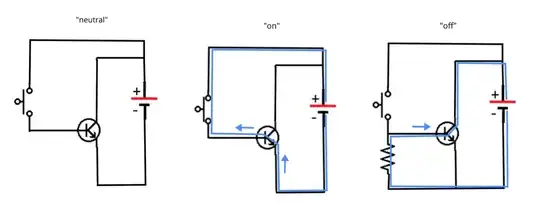

I am asking because I don't get why the preferred path changes direction when the switch closes.

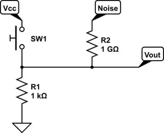

    OK, here's a different way to look at it: Let's add a "noise" source, which in this case will be another DC power rail with the same voltage as Vcc. Add a 10Mega ohm series resistor to the output of this power supply and connect that to the Vout node. Make R1 = 10K (a common pull-down value). I suggest using 3.3V for both VCC and Vnoise. Calculate Vout with the switch open and with it closed. The noise source in this case is a high-impedance output (much like actual noise). Since R1 is lower impedance than Vnoise, the voltage at Vout is biased much closer to ground than Vnoise. – Troutdog Sep 16 '21 at 20:45

[Edit] To address your latest edit: "I am asking because I don't get why the preferred path changes direction when the switch closes."
The preferred path is the one of lowest impedance. When the switch closes, which path is the lowest impedance changes.
The reason is because the resistor has infinitely less resistance than the switch when it is open. It also has a lot less impedance than the noise source.
When the switch is open, the only path for current is ground via R1. Assuming Vout is high impedance (compared to R1), noise that is impressed on the circuit (appears as voltage from a high impedance source) drains away through R1 before that voltage can get high enough to trigger Vout. This is because the source-impedance of the noise is much higher than the resistor.
When the switch is closed, that path is much lower impedance than the path to ground via R1 (or the noise), so the voltage can easily rise high enough to trigger Vout. The lowest impedance path is now between Vcc and Vout.
Understand that Vcc and GND are low impedance nodes, while Vout is high impedance. R1 might be seen as "medium" impedance. Current will flow more through the lowest impedance path.

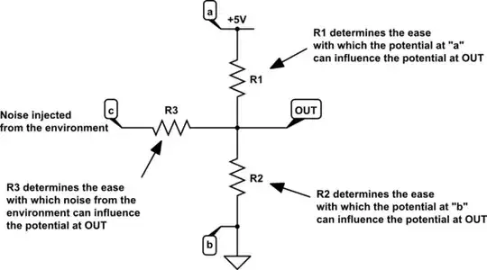

Model your noise like this:
schematic
Think about where the current goes and what happens to the voltage across the resistors. Pick a Vcc, pick a noise voltage (even though it is usually a type of A/C, pick some voltage) and use Ohm's law to calculate voltage at Vout and currents through the resistors. It will all become clear.

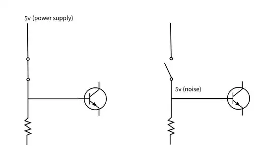

  • What I and the other people who wonder about this ask, is why the electricity from the power source wants to bypass the pull down resistor, but the electricity from the noise doesn't. In your last reply, you only address the noise. – LearningBasicComputerScience Sep 17 '21 at 20:00

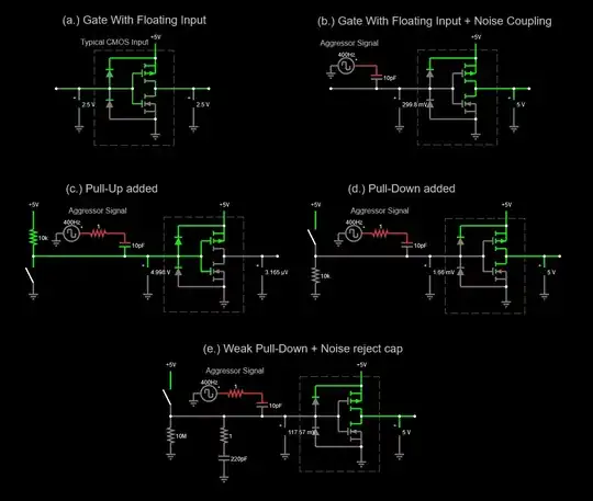

Here's a simulation of various tie-off scenarios involving a CMOS input (simulate it here).
About Falstad. Falstad is a Javascript-based interactive circuit sim that you can edit yourself. Falstad has some visual aids, including the 'current speed' that you adjust that to see where the current is flowing. You can also add scope probes to monitor current and voltage as needed.
About the circuits: Each sim is a typical CMOS input. It's modeled as a MOSFET P-N pair that forms an inverter, with a pair of ESD (electrostatic discharge) protection diodes that limit the gate voltage to between GND and VCC.
Now, let's go over the scenarios:
  • (a.) Floating input. The P-N pair biases to midpoint, due to the slight leakage of the ESD protection diodes. Both transistors are on, biased in linear mode, causing wasted DC current. Output sits at 2.5V.
  • (b.) Noise coupling. The P-N pair inverter amplifies it to a full-strength signal. Output follows noise.
  • (c.) Pull-up. Some noise makes it through, but not enough to trigger the inverter. Almost all the noise flows through the pull-up. Output stays low.
  • (d.) Pull-down. Again, some noise makes it through, but not enough to trigger the inverter. Almost all the noise flows through the pull-down. Output stays high.
  • (e.) Weak pull-down + noise reject cap. Some noise makes it through, almost all of it (>95%) is shunted to ground by the cap. Output stays high.
In each case the noise source is a 400Hz square wave signal: not a high base frequency, but being a square wave it has infinite harmonics so it will couple strongly even though its toggle rate is low.
In cases (b.), (c.) and (d.) I've provided a lower-impedance path for the noise, taking it away from the CMOS input:
  • Switch open, noise flows through the termination.
  • Switch closed, all the noise flows through the switch.

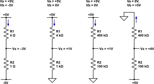

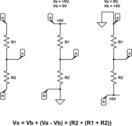

I'll start without the capacitor, and review the voltage divider:
schematic
In other words, the voltage at x is equal to:
the product of
  • The total potential difference across the divider chain
  • The fraction of the total resistance R1 + R2 represented by R2
offset by
  • The voltage present at the bottom of the divider chain
This is independent of current in the chain, and while that's an important consideration, I won't be talking about current just yet. Focus on the potentials.
This equation is an unassailable fact. It always works, for signals up to many many megahertz, and I don't care if the top of the chain is lower in potential, higher, millivolts or kilovolts, it falls right out of the application of undisputed Kirchhoff's and Ohm's laws. I can use it to know what the potential at x is, regardless of the signs or magnitudes of the potentials at a and b. Check for yourself:
schematic
simulate this circuit
From those examples, you can make an observation that Vx is closest to Va when R1 is small compared to R2, and similarly, when R2 is smaller, Vx tends towards Vb. In other words, R1's influence on Vx is such that it that causes Vx to approach Va as it gets smaller in resistance, and conversely R2 causes Vx to become closer to Vb, giving rise to the terms "pull-up" and "pull-down". If Va is more positive than Vb, you could call R1 a "pull-up", and R2 a "pull-down". That's all there is to this, it's only indirectly related to current by Ohms' law, and these terms are referring to the resistor's influence on the voltage at x, not current, or anything else.
I included indications of current flow (blue arrows), just for completeness, but again, I remind you that current results from the application of potential difference, and will depend on R1 and R2, but it has no bearing on the (unloaded) voltage at x. Current does not appear in our divider equation.
If we consider a switch to be a variable resistance which is either very low (0Ω) or very high (∞Ω), depending on whether it is pressed or not, then we can place it in the voltage divider, and treat it just like a resistance:
schematic
Applying the formula with these values for Va, Vb, R1 and R2, yields the expected voltages Vx, and to drive the point home, I don't care one iota about current direction or magnitude (at least, not yet).

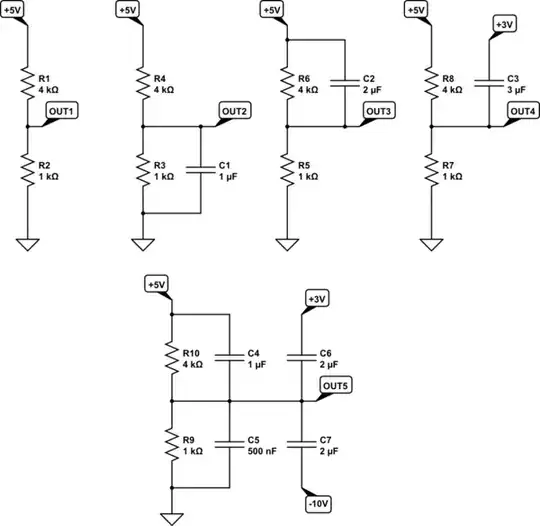

I want emulate a MOSFET gate input, like you'd find in most CMOS digital ICs, which would be some capacitance, perhaps to ground perhaps to Vcc, perhaps to some other potential entirely. I'll compare five resistive voltage dividers, all indentical with the exception of their capacitive loading. The first has no capacitive loading at x, one has a capactitor to ground, the next to Vcc, one to some arbitrary potential, and the last one with capacitors all over the shop:
schematic

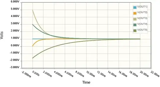

When we plot how the voltages \$V_{OUT1}\$ to \$V_{OUT5}\$ evolve over time, we get this:
Notice that \$V_{OUT1}\$, with no capacitive load, starts and ends at 1V, but crucially, given enough time, all the others converge to that same value. Whatever currents are flowing are causing each and every capacitor to charge to exactly the correct potential difference across it, so that \$V_{OUT}\$ is 1V.
What this means is that in the long term, it's as if the capacitors are not there. Their only influence is to delay the settling of the circuit to that "final" output voltage, the level defined by Va, Vb, R1 and R2. The capacitors are a hinderence, but only for a while.
The rate at which this convergence happens depends on the resistances and the total input capacitance, and now current certainly plays a more direct role in the divider's behaviour.
If you want \$ V_{OUT} \$ to slew really fast, you must have low resistances for R1 and R2, or low input capacitances, or both.

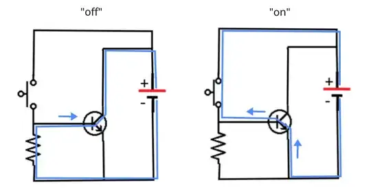

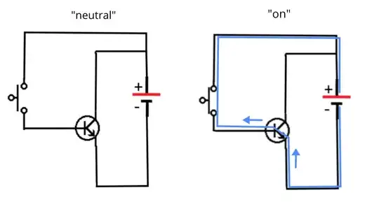

  • My best guess at the moment is that the Ohm of the base-emitter current of a transistor decreases as voltage applied on it increases. And that this makes it the preferred path, at a threshold. It is a perfectly logical explanation, so, it is what I'd guess. – LearningBasicComputerScience Sep 20 '21 at 01:32

Having understood what I missed, I’ll answer this question, in the way I think it explains what I asked. This could benefit anyone else who had the same question.
I assumed the pull down works by creating a “preferred path” for noise so that it bypasses the base. I also linked to a dozen other people who made the same assumption. This assumption is false.
How they actually work, is by connecting the base to a negative voltage. In schematics, this is shown as “ground”. I’ll skip the “ground” concept in my explanation.
Transistors can be in three states. They can be in “neutral”, and block electricity. They can be in “off”, and block it even more. And they can be “on”, and conduct electricity.
Transistors are turned “on” by a positive voltage at the base. And, “off” by a negative voltage at the base. And, they are in "neutral" with no voltage at the base.
It would be easiest to use transistors with just the “neutral” and “on” modes, since that is enough for them to either conduct or not conduct electricity. But, the wires in the circuit act as antennas and currents can be induced in them from electromagnetic “noise”, and it might be enough to turn the transistor “on”.
By adding the “off” mode (replacing "neutral" with it), any “noise” is outcompeted when the transistor is “off” (and already was when it is “on”. )
