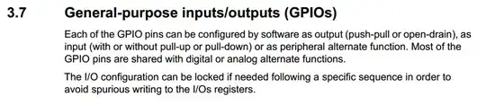

I am working with STM32 micro-controllers. These micro-controllers have the option to set the input pin as pull up or pull down:
Earlier I used to give external pull up or pull down resistor wherever required but now I am wondering whether I can do away with external components and use the pull down feature of the micro-controller itself.
Will that be a good thing to do?
Is there some use case where I should take extra precaution or not use this feature at all?

    I use the internal pu/pd whenever I can and had no problems sofar. So unless you have a valid reason not to use the build-in pull up/down you can just use them. A reason not to rely on the internal pu/pd could be that the input has a long wire connected to it which might couple to other lines causing unexpected behavior. The internal pu/pd is quite weak (to save current) and is more easily disturbed than for example a 10 kohm resistor. – Bimpelrekkie Nov 22 '16 at 09:46

Yes... You can... It's a proven feature. If you see pin structure in STM32 Reference manual, you can see that it has required components --
STM32 Pin structure
If this satisfies your requirements, then, you can do away with external components.
Edit Remember that at Power up, Pins will be tristated. If it does not hamper your application, it is good! That's why it's good practise to init IO section first and then go ahead with other peripherals.

In general, it is perfectly fine to use the internal pull-up or pull-down resistors.
Disadvantage is that you can forget to enable it from software, that can cause a little headache. The external pull-ups will always be there. So do not forget to enable the internal ones and save a lot of PCB area by reducing component number.
The STM32's internal pull-up and pull-down resistors usually have a value between \$ 30\small~k\Omega \$ and \$ 50\small~k\Omega \$.
You should always check if your application needs a certain pull-up or pull-down resistor value before using the internal resistors. For example do not use them with I2C, as these values will be too high for that.
