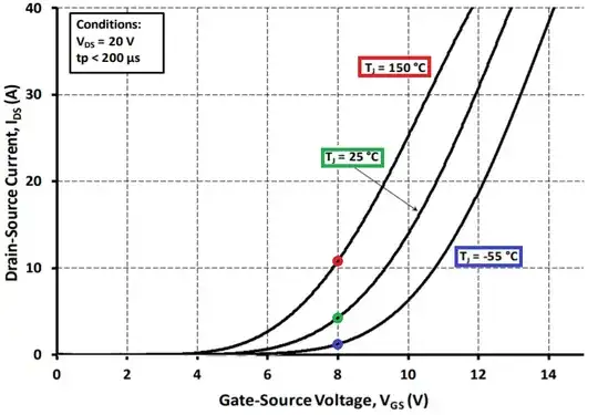

Several SiC MOSFETs I've looked at are worse than most regular MOSFETs in terms of thermal runaway (Spirito effect). This occurs in both linear applications and switching applications. For regular MOSFETs, it usually only occurs in linear applications.
If you have a particular SiC MOSFET you are considering, then look in the data sheet for this graph (example taken from a Cree CMF20102D SiC MOSFET): -
Evidence: if you apply a gate source voltage of 8 volts, you might expect to see a drain current of about 1.5 amps at -55°C. As the MOSFET inevitably warms to 25°C, the drain current will rise to about 4 amps and, of course, the SiC MOSFET would start to more rapidly warm.

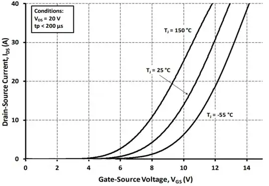

At 150°C the drain current is about 11 amps and you are going to get rapid device destruction if this isn't curtailed. So, with a gate-source voltage of 8 volts you can say that the drain current increases by 11/1.5 (7.333) times over the allowable temperature range of the device: -
This is a significant clue that the SiC MOSFET I targeted will suffer from thermal runaway if not carefully used. I'm not saying all SiC devices are like this but, several that I've looked at are similar.
On the other hand, at a higher gate source voltage such as 12 volts, the likely range of drain current is from about 7 amps to about 25 amps i.e. a ratio of 3.57. This means the problem gets less as you raise the drive voltage to the gate. But still, regular MOSFETs are more tolerant.

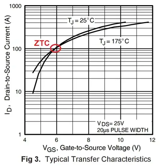

Compare this with an equivalent graph for the IRF3205 (a regular MOSFET): -
With a gate-source voltage above about 6 volts, this MOSFET will self protect by shutting down the drain current should its temperature rise. Note the circle (ZTC); it's the point of zero temperature coefficient and below that voltage the MOSFET is in its linear region and can suffer some degree of thermal runaway.
The SiC MOSFET data sheets I've seen do not converge to a ZTC point and so it should be concluded that switching applications and linear applications are both susceptible to thermal runaway possibilities.
