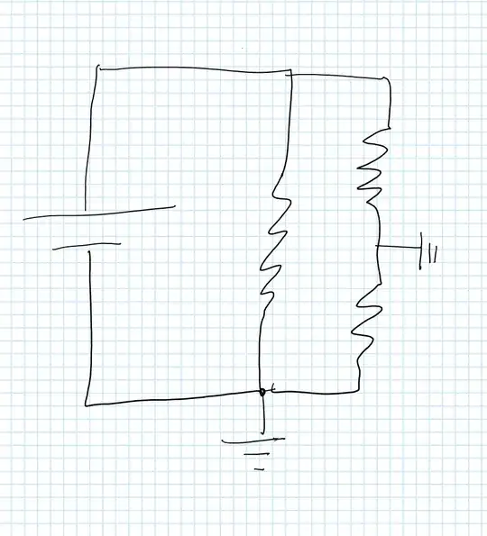

The following circuit is one where I think current should flow to and from ground (sorry for the poor diagram my computer is slow so I can't draw a proper one) enter image description here
    Current very rarely flows to what you've defined as "ground" in most circuits. Usually current flowing to earth ground is a failure mode in high voltage devices. – Ignacio Vazquez-Abrams Jan 11 '15 at 19:48
  • @IgnacioVazquez-Abrams I have added a diagram where I think current should flow to ground, irrespective of the voltage or the values of the resistors – Quantum spaghettification Jan 11 '15 at 19:53
    Your diagram changes nothing. The connections to earth ground short out the resistor, but no current would flow into earth proper. – Ignacio Vazquez-Abrams Jan 11 '15 at 20:01
  • @IgnacioVazquez-Abrams but current flows through the earth??, Also why does current rarely flow to ground expect at high voltages? – Quantum spaghettification Jan 11 '15 at 20:03
    Note that since there are connections to ground on both sides of it, the resistor at the bottom-right of your diagram has no real effect on anything. Unless you specify an isolated ground all ground connections are normally the same, so your two ground connections form a short across that resistor. – Jerry Coffin Jan 11 '15 at 20:31

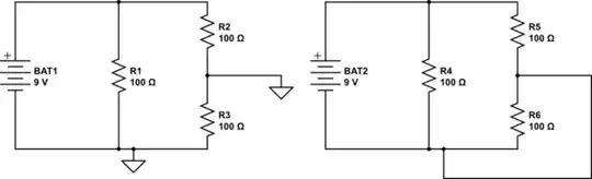

For instance, these two circuits are identical:
schematic

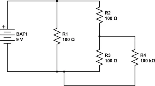

When you have real earth in there, the circuit is slightly modified to be more like:
schematic
simulate this circuit
The key point is that the current flows from one point of the circuit, through ground, then back into the circuit.
With only one connection to ground there is no circuit for the current to flow through. It can't flow "to" ground, because there is nowhere for it to flow to. There's no difference between ground and a wire dangling in the breeze.
