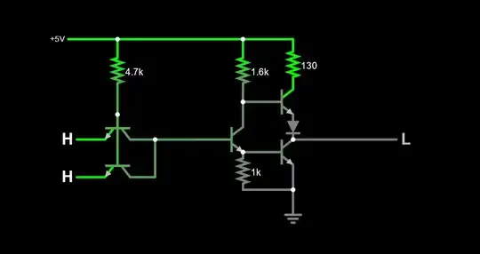

It's mostly about what T2 is doing. It works as a 'phase splitter', providing signals of opposite phase on collector and emitter. These opposite phases control T3 and T4 independently.
  • T2 off: T3 is on, T4 is off -> output high
  • T2 on: T3 is off, T4 is on -> output low
This phase-splitter arrangement can be found in most TTL gate implementations.
For the NAND function, what may be less than obvious is what T1 is doing. T1 dual-emitter NPN in the input behaves as follows:
  • Either emitter pulled low: brings T1 collector low, turning off T2 and bringing the output high.
  • Both T1 inputs high or unconnected: T1 base-collector junction is forward biased through T2 base, turning T2 on and making the output go low.
The bolded point is important: a transistor can behave as a pair of diodes connected together. The B-E junction is one diode, and the B-C junction is another.
In an NPN, positive B-C junction voltage will be in forward bias, allowing current to flow. And that's exactly what happens when the two emitters are disconnected: T1's B-C is forward biased, and conducts through T2 base, turning T2 on.
Try a simulation, here:
I've modeled the T1 dual-emitter NPN as two separate NPNs with their bases and collectors tied together, but the operation is the same: both emitters high or unconnected, base-collector junction is forward biased through T2.
