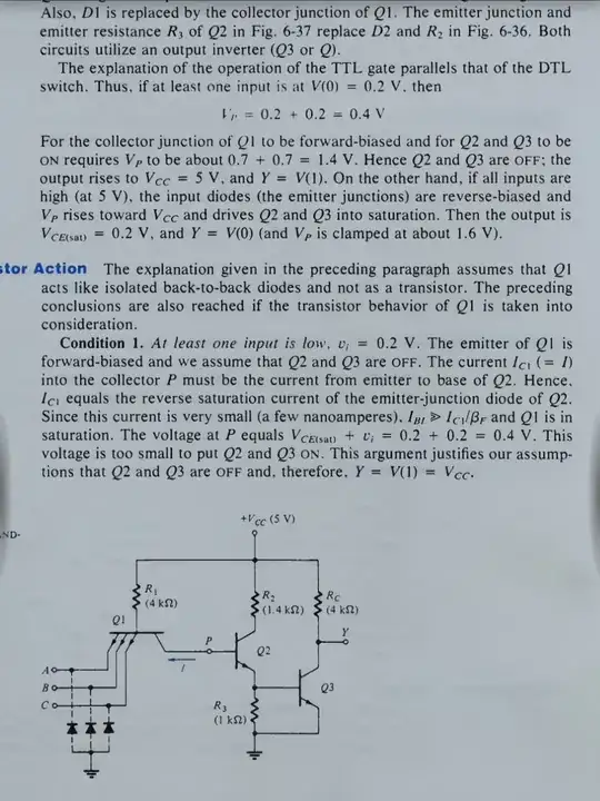

I am also attaching a screenshot of the page of the book.
First of all, is it correct to think that the transistor Q1 is in common-base configuration?
I am also struggling to understand the biasing of transistor Q1. In the below screenshot, the book says, the transistor Q1 is in saturation mode. That would mean both collector-base and base-emitter junctions are forward-biased. Then why do some resources, like this video at 6:13 minutes, say the collector-base junction is in reverse bias?
Also, the book mentions, as in the screenshot, "for the collector junction of Q1 to be forward biased, the voltage at point P should be 0.7 + 0.7 = 1.4 V". How can this be justified ?
I know very elementary facts about transistors; where does my understanding have a caveat?
Please help, as I am really struggling to get the concepts behind this.

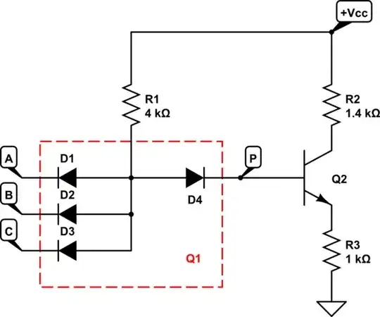

If all inputs are HIGH (connected to Vcc). The \$Q_1\$ base is also pull-up to \$V_{cc}\$ via a \$4k\$ resistor. Therefore the base-emitter junction is reversed biased. In a "normal situation", \$Q_1\$ should be cut off. But in this case, we have \$Q_1\$ collector connected directly to \$Q_2\$ base. And this changes the situation completely.
There is a path for a \$Q_1\$ base current from \$Vcc\$ to \$GND\$.
The \$Q_1\$ base current can flow from:
Vcc--->4k--->Q1 Base-collector junction ---->Q2 Base-emitter junction--->R3---->GND.
Notice that the \$Q_1\$ base-collector junction is now forward-biased, and that is why the current can flow. So in this scenario, \$Q_1\$ is working in inverse mode also known as a reverse active region.
When the input is LOW. The \$Q_1\$ transistor's base-emitter junction is forward biased. And since \$Q_1\$ collector is connected to \$Q_2\$ base. So, the current cannot flow out of \$Q_1\$ collector into \$Q_2\$ bas, thus \$Q_2\$ is cut-off. And in this case, we can say that the Q1 transistor will be saturated. Because the collector will be "flooded" by electrons injected from the emitter.

  • Yes, Q1 is working here as four diodes. 3 x base-emitter diode, and one base-collector diode. – G36 Mar 31 '23 at 09:15
    So you do not see that Q1 collector is directly connected to Q2 base? – G36 Mar 31 '23 at 09:16
  • Ok yes yes, I understood. :) it is clearly apparent. Sorry. – curious_mind Mar 31 '23 at 09:17
    I added Q1 equivalent circuit. – G36 Mar 31 '23 at 09:25

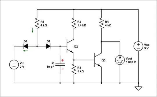

Vin = 0 V
DTL. When the input voltage is zero, D1 diverts the R1 current through itself; both D2 and Q2 are cut off (the current is "steered" to D1). The problem is that there is no return path for discharging the charge accumulated in the base, the charged stray capacitance C, leakages, etc.

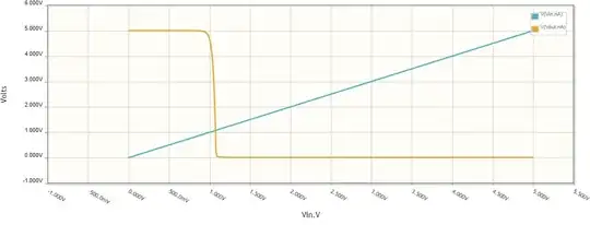

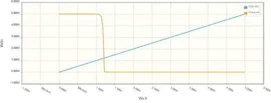

Let's now see the transfer characteristic Vout = f(Vin) by the help of DC sweep simulation. As you can see, I have set the input voltage Vin to vary from 0 to 5 V.
DTL - Vout=f(Vin)

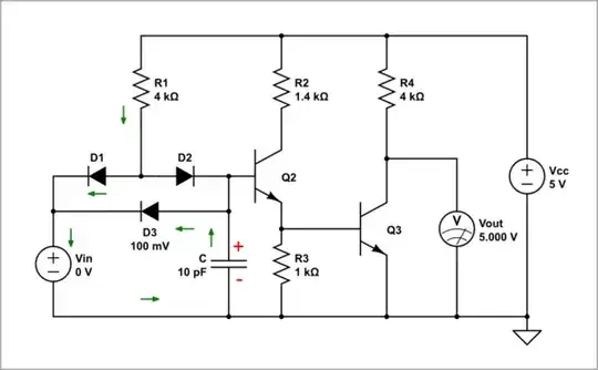

Improved DTL. So I would add an ideal diode D3 (with 100 mV forward voltage) in parallel to the network of two back-to-back diodes D1 and D2 to mimic the turned on transistor in the TTL gate below.
schematic
simulate this circuit

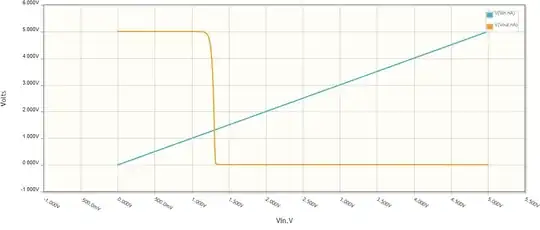

DTL modified - Vout=f(Vin)
The transfer characteristic Vout = f(Vin) is almost the same as above; there is only a small shift to right that should be explained...

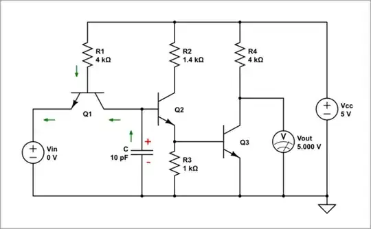

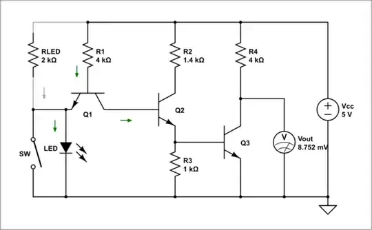

TTL. Here, the Q1 base-emitter junction corresponds to D1 and the base-collector junction to D2. Since the Q1 emitter is grounded and its base is connected through R1 to Vcc, Q1 is turned on and can sink a collector current. So the capacitor C will be quickly discharged through the Q1 collector-emitter part and the Q2 base will be firmly grounded.
schematic
Mimicked "charged capacitor". Since I don't know how the initial conditions of the capacitor can be set in CircuitLab, I have imitated it with the "pull-up" resistor Rtest.

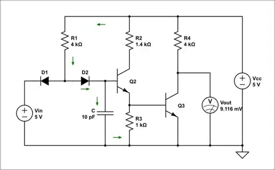

Vin = 5 V
DTL. Now D1 is backward-biased and the R1 current is steered to right through D2 and Q2 base-emitter junction. So the Q2 collector current is increased enough and Vout is almost zero.

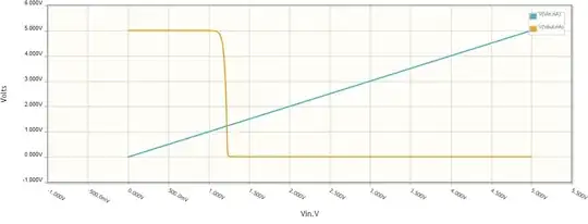

Let's now see the transfer characteristic Vout = f(Vin) as above (the input voltage Vin varies from 0 to 5 V)...
TTL - Vout=f(Vin)

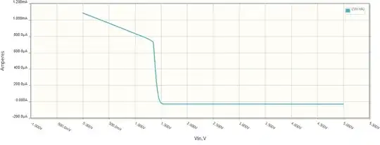

... and the input characteristic Iin=f(Vin).
TTL - Iin=f(Vin)

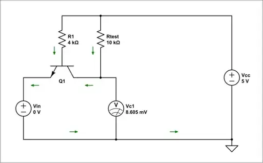

Mimicked inverse active mode. So to see it anyway, I decided to do the following trick - I "reversed" the transistor, with the collector out to 5V (as it works in "normal active mode") and reduced its beta a lot (below 1). So I was able to observe something close to my expectations.

The transfer characteristic Vout = f(Vin) is almost the same as above; there is only a very small shift to left...
TTL with 'inversed' Q1 - Vout=f(Vin)

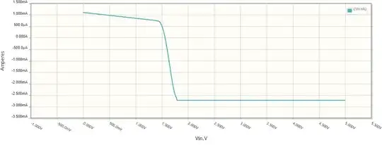

... but the input characteristic Iin=f(Vin) is quite different.
TTL with 'inversed' Q1 - Iin=f(Vin)

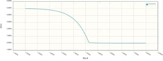

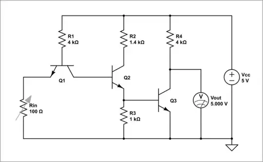

"Input resistor". Finally, I decided to reproduce the incomprehensible (to me) experiment from my student years. I used the DC sweep simulation by setting the resistance of the "input resistor" Rin to vary from 1.5 k to 2 k.
schematic
As you can see, the output voltage changes from 5 to 0 V as if there was an input voltage changing from 0 to 5 V like above. This is because the R1 current IR1 "creates" a voltage drop Vin = Rin.IR1 that gradually increases when Rin increases. You can also consider the two resistor (R1 and Rin) in series as a voltage divider with varying transfer ratio.
