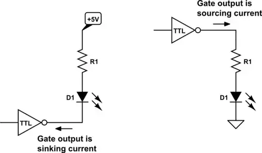

To complicate matters, their outputs are far better at sinking current (from a higher potential), than sourcing (to a lower potential). In other words, they are better at "pulling down" (where current is drawn into the output, from a higher potential) than "pulling up" (in which case current is leaving the output, flowing to a lower potential). For example, it's generally OK to connect an LED between a TTL output and +5V (below left), but not to ground (right):

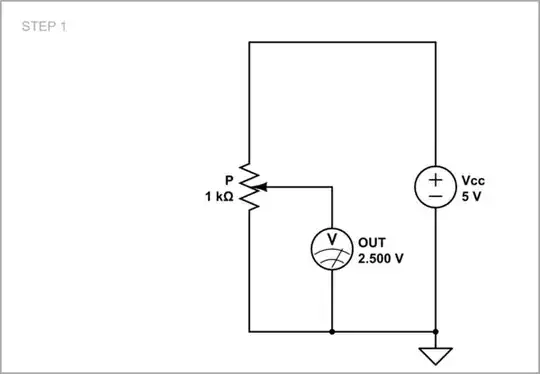

Potentiometer
This idea was implemented in its simplest electromechanical form already in the 19th century as a potentiometer. A unique property of this device is that when we move the wiper, the total resistance, current and voltage remain constant; only the ratio between partial resistances and voltage drops changes...
schematic
... and we use one of the voltages (usually the grounded one) as an output voltage Vout. Use DC sweep simulation.

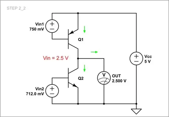

Vin = 2.5 V (Vin1 = 750 mV, Vin2 = 712 mV). During the transition, both transistors must pass current (the output should not remain "floating") and the output voltage must be equal to half of the supply voltage. Adjust Vin1 and Vin2 carefully to achieve this condition.

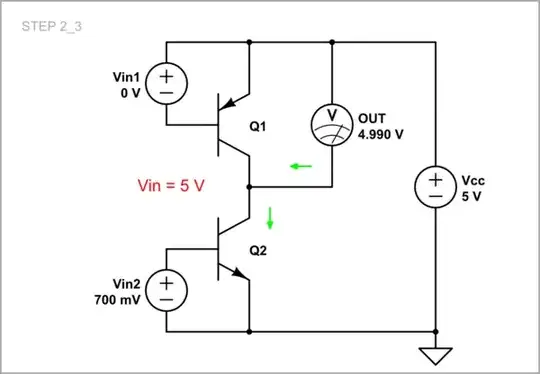

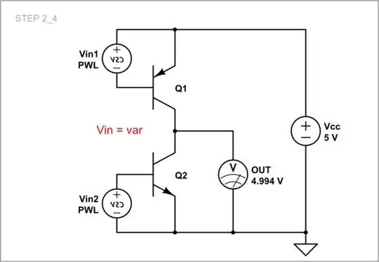

Vin = 5 V (Vin1 = 0 V, Vin2 = 700 mV). Now the roles are reversed - Q1 is off and Q2 on. A current flows through the load (a voltmeter with intentionally reduced to 10 k resistance), enters and flows through Q2. The stage is sinking.
schematic
simulate this circuit

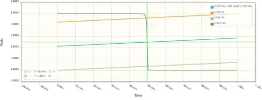

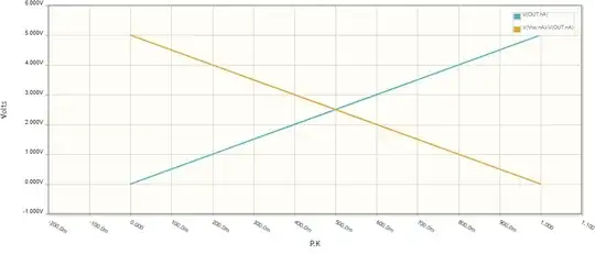

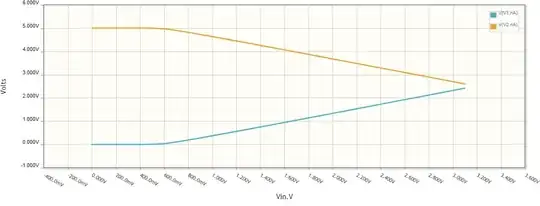

Vin = var (Vin1 = 750 mV - 0 V, Vin2 = 0 V - 697 mV). Finally, let's investigate the stage by a linearly varying input voltages to see the transition. Since I have used CSV voltage sources, use time-domain simulation.
schematic
As you can see from the graph, the characteristic resembles that of the CMOS stage. It is very steep in the middle because the transistors behave as current sources at the time of switching (dynamic load) and reach the supply rails when they are on. So our "CTTL stage" is almost perfect.

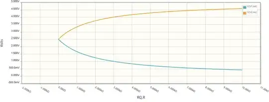

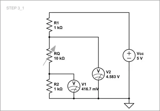

When we vary RQ, the common current through the three resistors in series varies (unfortunately non-linearly) and the voltage drops across R1 and R2 vary as well. So if RQ is a voltage-controlled resistor, the two transistor input voltages will be controlled by the single input voltage.
STEP 3_1
Practical phase splitter

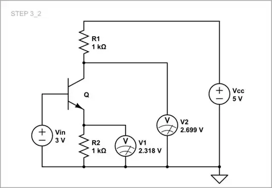

It remains only to replace the variable resistor with a transistor Q that will act as a voltage-controlled "resistor".
schematic
Now the voltage drops across R1 and R2 depend almost linearly on the input voltage.

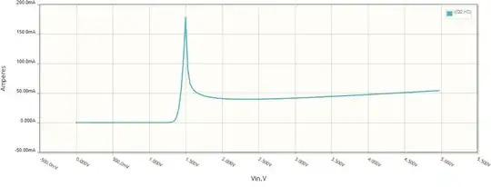

... and sweep Vin. But what is this significant current surge at the moment of switching?
STEP 4_1

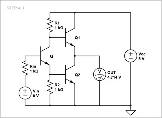

Aha... clear! This is the moment when both transistors are "on". We need to somehow reduce the overlap and limit the current surge.
Classic TTL output stage
We notice that when Q is on, only the Q2 base-emitter junction is in parallel to Q1 base-emitter junction and that is not enough to be Q1 off. We need to insert another diode somewhere in the loop. The designers chose to put it in the emitter of Q1 apparently because the current is higher there. Then, to limit the current, let's insert a 130 ohm resistor R3.
schematic

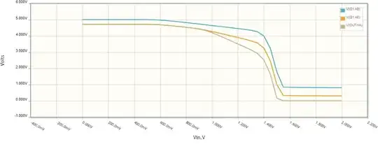

Now let's see how the output voltage changes.
STEP 4_2a
At the moment of transition, the current is significantly reduced.
STEP 4_2b

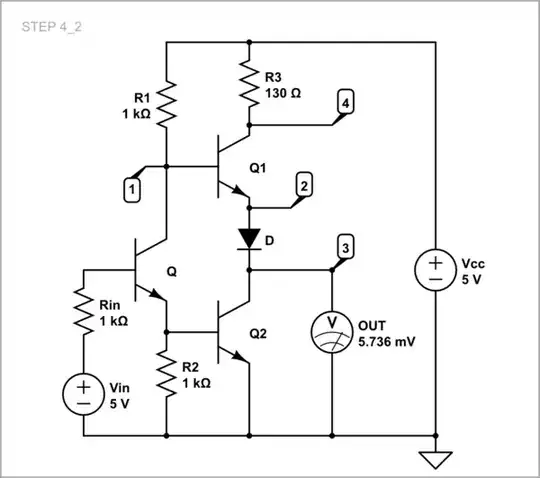

Why the HIGH output voltage is low
A bunch of problems lead to this:
  • A voltage drop is lost in the resistor R1
  • Another voltage drop is lost in the resistor R3
  • 0.7 V is lost in the emitter follower Q1
  • Another 0.7 V is lost in the diode D
You can see it in the graph below.
STEP 4_2c

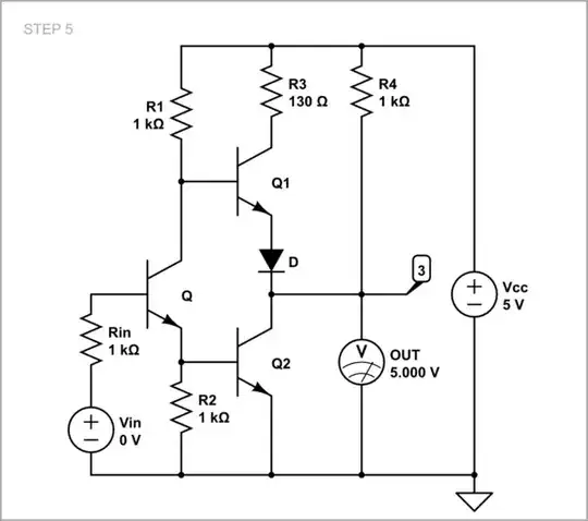

How to make it high
We can "pull up" the TTL output by another resistor R4 connected to Vcc. The trick is that diode D is off and disconnects Q1 from the output.
schematic
As you can see, the output voltage is almost 5 V but only if there is a high resistance load connected.
