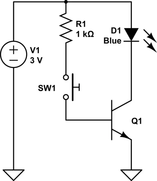

The base-emitter junction is like a diode. When the voltage across it (Vbe) exceeds approximately 0.65V (can be as low as 0.55V and as high as 0.9V, check the datasheet for your transistor) it begins conducting.
The current (not voltage!) through the base emitter junction is amplified by the gain of the transistor, which is known as HFE. Ic(collector current) = Ib(base current) * HFE. Remember HFE is not constant for transistors, it varies from transistor to transistor and depending on temperature, previous usage, etc., so don't rely on it for controlled amplification. For the 2N2222 it is around 160, plus or minus 30.
By applying a base-emitter voltage exceeding 0.65V to the transistor you can use it as a switch.
schematic
(It is an NPN transistor you want. 2N3904 or 2N2222 will do.)
If you want to use an LED which is not blue or white then use a 47 ohm resistor in series with it.
When you press the switch the LED will come on.

  • with a 2n2222, Vbe at saturation of 0.8V is not uncommon. Typical Vce at saturation is around 0.2V, so if you see more than 0.25 or so, you need more base current. – JustJeff Oct 18 '10 at 22:10
  • That's why in my circuit I demonstrated connecting to +3V. No one voltage will fit for all transistors. Some transistors conduct well as low as 0.55V, and I've seen many bipolar transistor based circuits (like oscillators) that work well down to 0.5V. – Thomas O Oct 18 '10 at 22:15
    You should probably mention in 2nd paragraph that it's the current through the collector that is an amplification of the current through the base. I.e. collector current = base current * HFE. – Craig McQueen Oct 18 '10 at 22:39
    +1 for the current comment in this answer. I feel like this was a major mistake during my learning of electronics (and not just limited to transistors). Current matters, you won't get anywhere without some electrons moving at some point. – Chris Gammell Oct 19 '10 at 18:53
    Wait, what? You mean a transistor in "switch mode" acts NOTHING LIKE A SWITCH? I.e., it's the current applied to the base multiplied by the Hfe which governs the current south of the emitter, rather than whatever load is hanging off the emitter and the voltage across the collector and emitter? – Robert Atkins Oct 20 '10 at 17:37
  • Imagine the base-emitter junction is a diode (it is, but it's a bit more complex.) The current through the diode determines the current coming into the collector. The emitter current is the sum of the base current and collector current. In saturation, which is what this is being used as, the transistor acts as a switch and drops 0.1-0.2V. – Thomas O Oct 20 '10 at 17:44
    ARGH! I've just worked out what I'm doing isn't working! Instead of GROUNDING the emitter and putting the load (a string of LEDs) between the positive end of the power supply and the collector, I was putting the load between the emitter and the negative of the power supply. Sometimes it's hard because you just don't know what you don't know. – Robert Atkins Oct 21 '10 at 09:13
  • Putting the load after the emitter would work but only if you could tolerate 0.7V of drop across the transistor. So if you had an LED that operated on 3V it would be no good after the emitter because the LED would only see 2.3V with a 3V supply. – Thomas O Oct 21 '10 at 12:12
