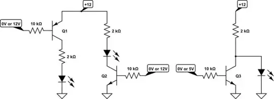

Update: Based on the comments, if the control signal will be either +12V or 0V you could do this:
schematic
If the control signal only outputs something like 0 or 5V you can use the circuit on the right to invert it.
The 2K resistor is picked for about 5mA of LED current.
Instead of using the NPN transistor on the left you might be able to drive the optocoupler LED directly from the control signal if it can supply enough current.
For the transistor side of the optocouplers, connect COM to the collectors and UP and DOWN to emitters. That will allow current to flow from COM to each of those terminals.

  • I am familiar with how to drive a relay with a transistor, I am trying to avoid having to add a power supply into the mix. I was hoping I would be able to do something with the current available to me. When I tried this configuration yesterday it still wasn't enough power to drive the coil on the relay, I am sure I could spec a lower current relay but I have a box of various NPN and PNP transistors and anything else I could need to do this. – Evan Jun 16 '21 at 18:56
  • I would try using an optocoupler next. – ErikR Jun 16 '21 at 19:03
  • an optocoupler would work for the connection. I need 2 though, I need one to be engaged when the input to this circuit (output of my thing) is low, and then when it goes high engage a different optocoupler and disengage the first one. I think I might need to make a NOT Gate or something like that to invert the signal for one of them? Hopefully, I am painting a good picture here... – Evan Jun 16 '21 at 19:13

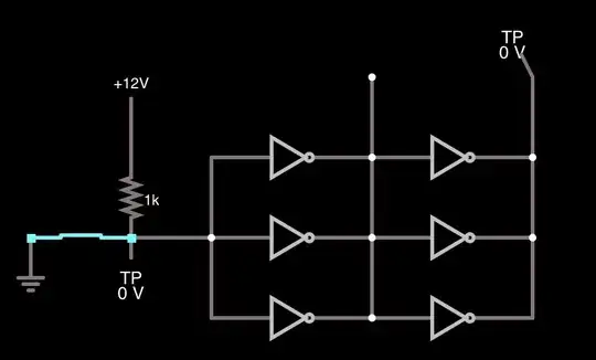

CMOS 4049 inverters have an output resistance around 300 ohms at Vcc=12V so tying then together reduces that to 100 ohms which at 10mA drops 1V so you can use a 13V supply if you like.
If you specify a tolerance on Vout , there are better FETs with much lower resistance.
But this is one solution that can be wired in an IC socket without a PCB. Just add a 0.1uF decoupling cap across 12V to 0V. So use the inverting 4049. enter image description here
When the switch is closed 0V, the 1st stage out is Hi and 2nd stage is low. And visa versa.
