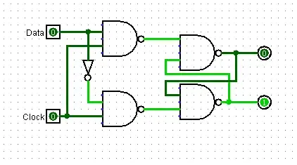

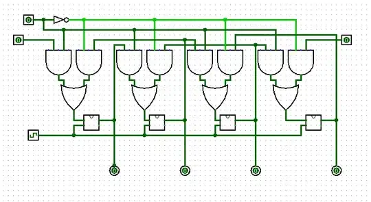

I am trying to create a D Flip Flop to use in a bidirectional 4-bit shift register, using Logisim. However, when using my D flip flop the shift register acts just as a normal register setting the bit for all 4 D flip-flops outputs instead of one by one. It works properly when using the D flip-flop provided by Logisim but I am wondering how to achieve this using my own D Flip-Flop.
This is the design of my D Flip Flop This is the design of my D Flip Flop
And this is the shift register (with the boxes representing the D Flip Flop) enter image description here

D flip-flop provided by Logisim which you used for simulation was a positive edge-triggered D Flip-Flop. While what you have designed is a level-sensitive D latch.

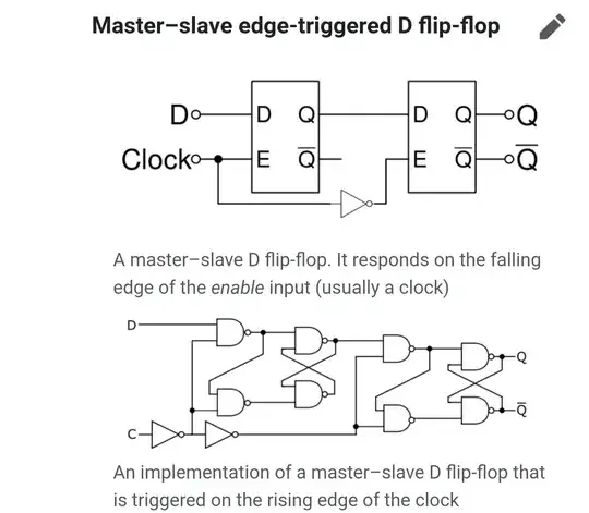

You have to cascade two of those D latches in master-slave configuration to obtain a positive edge-triggered D Flip-Flop.
reference: Flip-Flops Wikipedia

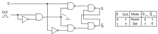

  • For a rising-edge detector you can use the same configuration as the upper diagram, but put the not-gate on the other enable-pin. – Rd Basha Oct 25 '22 at 18:12
Shorten your clock pulse so that it is gone by the time the output data from one flip flop reaches the D input of the next. At the moment, with a long clock high time, when the new data arrives at a D input it is transferred straight through the flip flop and on to the next because the clock is still high.
This is a technique for producing a very short clock pulse, the duration of which is shorter than the time taken for the data to transition through the stage.

    Unfortunately, even of you set the clock to Ton to 1 tick and Toff to 31 ticks, it still doesn't work. I suspect it calculates differently the states for the builtin D flip flop. – a concerned citizen Nov 18 '20 at 16:59
    @aconcernedcitizen yes, latches are different from flipflops. – user253751 Nov 18 '20 at 17:14
  • @user253751 True, but in real life you might get away with the inherent delays (also why you posted your answer). One of the reasons why I called it "concoction". – a concerned citizen Nov 18 '20 at 19:59
