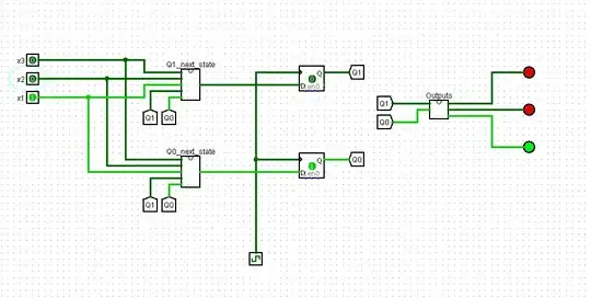

I have already designed the circuit. When using the built-in Logisim D flip-flop, the circuit operation is correct.
example operation when there is traffic on road 1 only

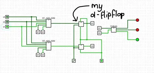

The assignment however requires us to implement the D flip-flop ourselves. I made a d flip flop as a subcircuit, and it seems to be working fine (outputs as expected)
my dflipflop implementation However, when using my d flip flop in the main circuit, it works when only one of the inputs is asserted. enter image description here

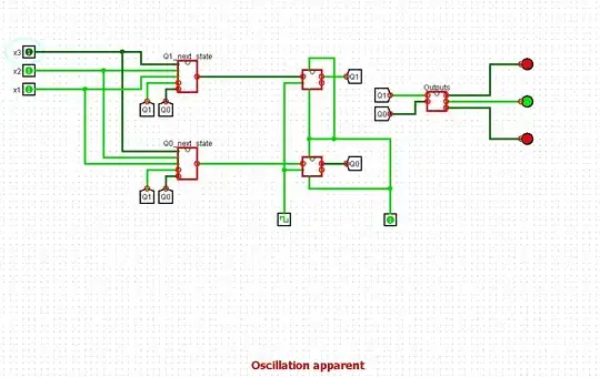

If more than one input is 1, instead of alternating red and green lights, I get an "oscillation apparent" enter image description here
The error definitely seems to be with my d flip flop implementation, and more specifically the asynchronous inputs, but I can't figure out what's wrong.

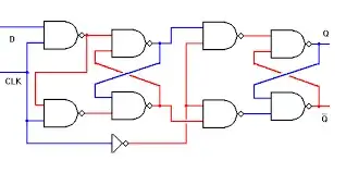

Your problem is that your implementation is a D latch not a D flipflop. A D flip flop is made up of two latches in series using an inverted clock on the last latch.

  • Ok, I didn't know there was a difference between the two! Read up on race conditions and all, and this master-slave setup seems to overcome this problem, right? Also, another question, the input to the lower left-most nand gate is the output of the upper left-most nand gate. Why is that so? Why not complement D and feed as input to the lower nand gate? Would this also work? – rhododendron Dec 19 '20 at 15:26
  • Yes it would. This solution this solution saves that gate. – RoyC Dec 19 '20 at 15:46
