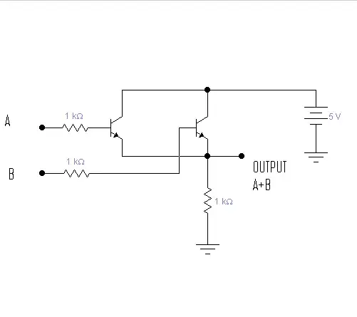

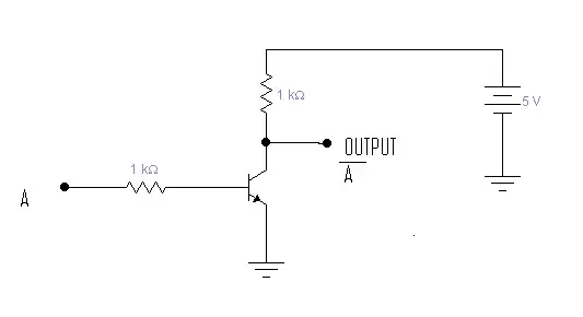

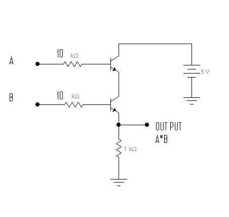

Using RTL (Resistor-Transistor Logic).
Also, some gates are made by combining gates. For example, an XOR is an (OR) AND (NOT AND). Also, a NAND is just an inverted AND.
An inverter and a NOR: http://en.wikipedia.org/wiki/Resistor%E2%80%93transistor_logic
An OR is an inverted NOR.
An AND is a NOR with inverted inputs.
A NAND is an inverted AND.
An XOR is an OR ANDed with a NAND.
An NXOR is an inverted XOR, or an AND ORed with a NOR.
