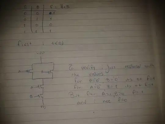

I have to create a CMOS circuit from the logic function: F= ~A + B (notA or B). I made the truth table but I'm stuck here trying to make the CMOS circuit. Any ideas anyone? Thanks!
CMOS.
I know it's the CMOS circuit for the NAND gate. I tried to change to get the results I want but I'm stuck.

  • i searched for this before i post the question. I m asking about this specific logic function. I m familiar with this but this one, i cant solve it. – Christakitos Jan 22 '15 at 00:12
  • Please show us what you've tried. In essence, everything you need is in the answer there. –  Jan 22 '15 at 00:14
  • What was the circuit you drew? What did you do to verify? What is the expected result and what is the actual result? Please [edit] your question to provide more information. –  Jan 22 '15 at 00:21
The base CMOS logic elements you have are NOT gates, NAND gates and NOR gates. So you need to convert your function to use only those gates. You have an OR gate in your function, so you need to convert this into one of the above three gates. There are two ways of doing this which stand out:
(1) What do you need to do to use a NOR gate? The answer to that is as simple as it seems. [Hint: how do you make a NOR gate into an OR gate]. Now you know the circuit in its base elements, simply join the CMOS equivalents together. [Hint: you will have 3 CMOS elements to connect up]
(2) The second option results in a much simpler CMOS implementation. It does however rely on a rather cool boolean logic equality: !A + !C = !(A . C). Using that equality, what must C equal to make the left hand side equal to your function? After you replace C, implement the function on the right hand side with CMOS elements. [Hint: you will have 2 CMOS elements to connect up]
FYI: The circuit in your picture is a NAND gate.
