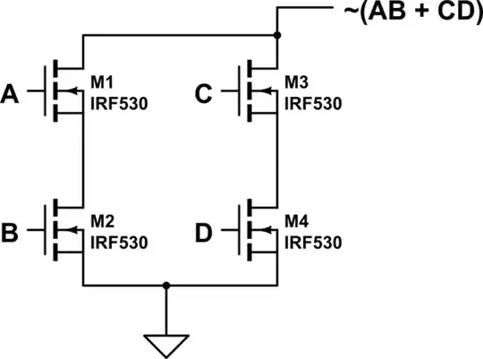

You're correct; that is not the right thing to do. The key is to take advantage of the ability to implement AND and OR via wiring. For example, here's a pull-down network that ORs together the results of two AND operations:
schematic
Note that the OR doesn't require any extra transistors at all. ANDing together two ORs is similar. Using this method, you can implement ~(A~B + ~AB) using twelve transistors, including the inverters. There are more efficient ways that use transmission gates or dynamic logic, but I don't think you can go below twelve in traditional CMOS logic.

  • I'm pretty sure that circuit doesn't work properly. Won't it leave the output floating when it's supposed to be high? –  Nov 30 '14 at 04:39
    Yeah, that's why I said it's just the pull-down network. The pull-up network is complementary and can easily be derived from the PDN. I was trying to avoid giving too much information for what might be a homework problem. – Adam Haun Nov 30 '14 at 04:50
