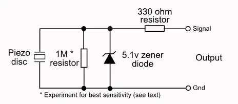

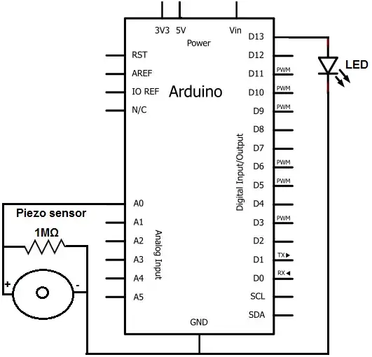

Please post a circuit when asking questions. A parallel resistor with a proper value is what you need. The current isn't high. The first circuit is with Arduino. The second circuit is recommended.
The circuit shows a 1MR resistor.

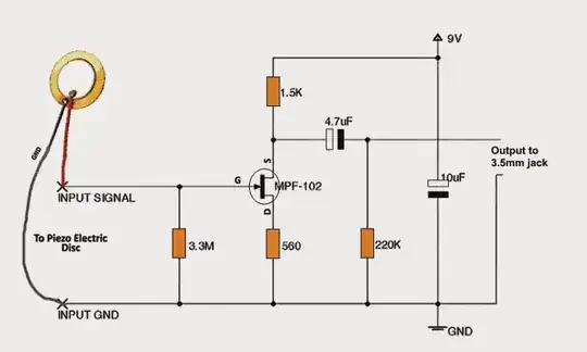

More complex option:
And the best way, but you have to reduce the voltage to 5V or 3.3V, depending on your MCU. enter image description here

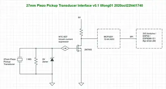

(1) It is not absolutely necessary to use the ICL (Inrush Current Limiter) NTC thermister to suppress the inrush current. An alternative is to use a series current limiting resistor, say 300Ω. However the NTC-5D7 with only 5Ω resistance should have a better performance.
(2) It is not absolute necessary to use the SPI 12bit single channel ADC MCP3201. The Arduino's GPIO pin with 10 bit rseolution should be OK to do the preliminary testing. For highly sensitive applications, higher resolution ADC, 16-bit, 24-bit can be used.
The MCP3201 is chosen for the following reasone: (a) Single channel MCP3201 is easier to learn and program than the though much more popular 8 channel 10 bit MCP3008. (b) I have written a tutorial and a fully debugged python demo program for MCP3208. So those not using Arduino, eg, Rpi, BBC Micro-ibt, Cortex M0 etc can use micro python or circuit python to run my demo program, with little program modifications.

Appendix B - Piezo pickup interface schematic

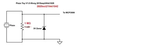

Errata and apology
My previous schematic has a typo error. The parallel resistor should read 1MΩ. Many thanks to @tomnexus for point out my silly mistake.
piezo cct

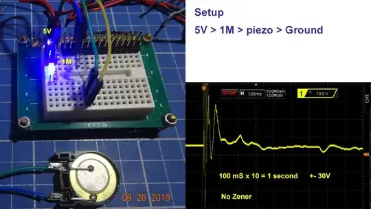

Appendix C - Voltage spike waveform display with and without Zener protection
zener protection

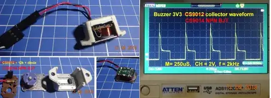

Appendix D - Detecting (Electromagnetic Buzzer) flyback voltage and current spike experiment
Detecting (Buzzer) flyback voltage and current spike experiment 1/2
Detecting (Buzzer) flyback voltage and current spike experiment 2/2
buzzer voltage spike

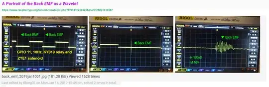

Appendix E - Buzzer Back EMF 30Vpp 100 ns Spike Wavelet Selfie
The voltage spike can be as scary high as 30Vpp, But the duration is small 100nS. If the human finger lightly taps/knocks the piezo disc, the mechanical energy transferred to the piezo disk should be of the same order of the 5V electromagnetic buzzer's little hammer hitting the bouncing steel spring bar. It is tedious to use my scope's one shot trigger to display my tapping of the disc. So I used the buzzer to display the repeatedly back EMF voltage spike. I did use my scope to zoom in the spike and found her a pretty little wavlet, so I took a selfie picture for her.
Warning to the OP:
(1) But if you are using a big hammer to hit a big disc which is part of a percussion musical instrument, then the spike might be as ridiculous high as 1000+ volts! and for pretty sure fry your ATTiny85.

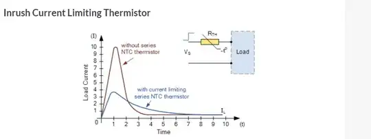

Appendix F - NTC Thermistor as In Rush Current Suppressor
NTC (Negative Temperature Coefficient) Thermistors temperature sensor/transducer/in rush current limiter - Electronics Tutorials
acl
Inrush current suppressors and surge limiters are types of series connected thermistor whose resistance drops to a very low value as it is heated by the load current passing through it. At the initial turn-on, the thermistors cold resistance value (its base resistance) is fairly high controlling the initial inrush current to the load.
As a result of the load current, the thermistor heats up and reduces its resistance relatively slowly to the point were the power dissipated across it is sufficient to maintain its low resistance value with most of the applied voltage developed across the load.
Due to the thermal inertia of its mass, this heating effect takes a few seconds during which the load current increases gradually rather than instantaneously, so any high inrush current is restricted and the power it draws reduces accordingly. Because of this thermal action, inrush current suppression thermistors can therefore operate very hot in their low-resistive state. As such require a cool-down or recovery period once power is removed thus allowing the resistance of the NTC thermistor to recover sufficiently ready for the next time it is needed.
The speed of response of a current limiting thermistor is given by its time constant. That is, the time taken for its resistance to change by by 63% (i.e. 1 to 1/ε) of the total change. For example, suppose the ambient temperature changes from 0 to 100oC, then the 63% time constant would be the time taken for the thermistor to have a resistive value at 63oC.
NTC thermistors provide protection from undesirably high inrush currents, while their resistance remains negligibly low during continuous operation supplying power to the load. The advantage here is that they able to effectively handle much higher inrush currents than standard fixed current limiting resistors with the same power consumption.

    Uh, $m\Omega \ne M\Omega$ – tomnexus Oct 21 '20 at 02:23
    @tomnexus, Many thank for pointing out my silly mistake. My apologies for any confusion caused. Cheers. – tlfong01 Oct 21 '20 at 02:36
    I'm affraid you misunderstood the reason for NTC in that inrush limiting circuit. There is absolutely no point to have it like you suggested. You can put there simple resistor and you will get the same result: a low pass filter. – Chupacabras Oct 21 '20 at 13:06
  • @Chupacabras, Many thanks for pointing out my possibly misuse of NTC. Actually I am not very sure if my suggestion is correct. My reason for using NTC is summarized below. (1) If using a, say 300R can limit the inrush current (perhaps inappropriate to use the term "inrush" here). The use of NTC with much bigger resistance than 300R, and later 5R, should be better. I did hesitate to use NTC, because *I have not checked the response timing of NTC*. (2) I would appreciate it if you can kindly advise why NTC should not be used here. Many thanks again. Cheers. – tlfong01 Oct 21 '20 at 13:25

    @tlfong01 No, we are not solving inrush current here! – Chupacabras Oct 21 '20 at 18:20
