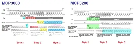

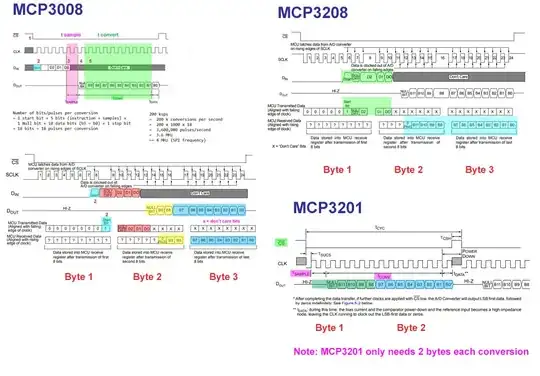

MCP3008 and MCP3208 Programming Notes

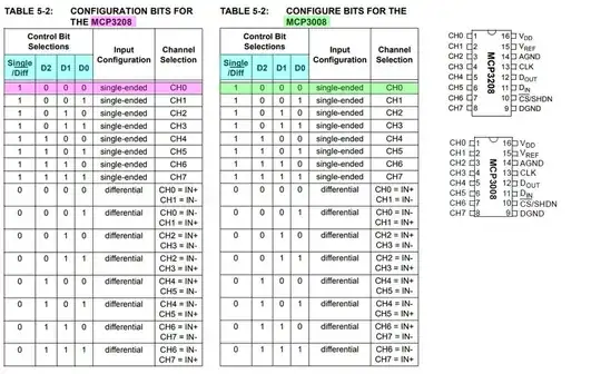

Now that all basic MCP3201 functions have been tested OK, it is time to move to MCP3008 and MCP3208, both of which are more complicated that MCP3201 (Note 1). Some differences are listed below. (1) MCP3201 only need to read two bytes to get results, no writing command to select which channel is to read. For MCP3008 and MCP3208, three write read bytes are need, as illustrated below.
Note 1 - The nice thing is that (a) MCP3008 MCP3208 have the same 16 pin DIP pinouts, (b) the config pins are identical (see Table 5.2 of both datasheets). In other words, there are little changes need to be made converting MCP3008 to MCP3208 and vice versa.
mcp3x08 config 1
mcp3x08 config 2

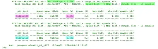

Update 2020aug17hkt1511

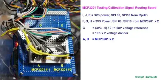

Now I have wired two MCP3201s for troubleshooting and cross/self calibration. I found that the accuracy is < 0.5%, max/min difference for 10 samples < 0.015V.
Next step is to test and calibrate MCP3208 and MCP3008.
dual mcp3201 test
dual mcp3201 test 3

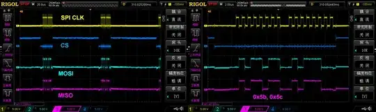

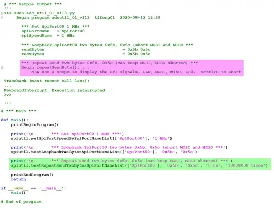

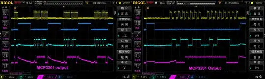

Now I am using a scope to display the SPI signal waveforms of loopback two bytes 0x5b, 0x5c at 1 MHz. Reading or converting MCP3201 and MCP30008/MCP3208 is as simple as reading two/three bytes. The following screen capture shows the two bytes loopback testing. The MCP3201 conversion wiring is the same, except MOSI and MISO is not shorted, but all signals are connected to MCP3201.
loop back test
repeat send two bytes

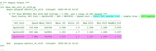

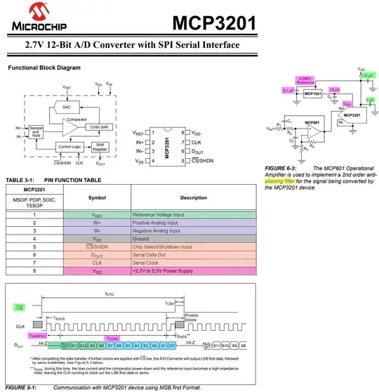

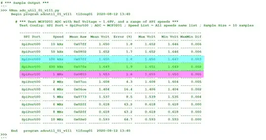

The OP is using SPI speed 1.35MHz to do the testing. Now I am testing MCP3201 the accuracy of converting a voltage of 1.68V with the voltage reference also 1.68V (Vcc/2) without using any by pass capacitors at MCP3201 Vcc and voltage reference. I tested over a range of 10kHz to 10 MHz. I found that the readings at 1 MHz or over is unreliable. So from now on I will only test at 1Mhz or below.
mcp3201 test 10khz to 10MHz
Now I am testing again, this time only on 100kH, 400kHz, and 1MHz, and over 100 samples. I found there is not much accuracy advantage using lower 100kHz and 400kHz, so from now on I only focus on 1MHz.
mcp3201 test 2

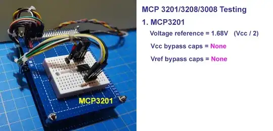

My test plan now is to first try one channel MCP3201 because the wiring and software is very simple, and techniques acquired can easily scale up to 8 channel MCP3208 and MCP3008.
I am starting the prototype hardware without any by pass caps for both Vcc and Vref. If I find results bad, then I will add bypass caps to compare and contrast.
mcp3201 test 1

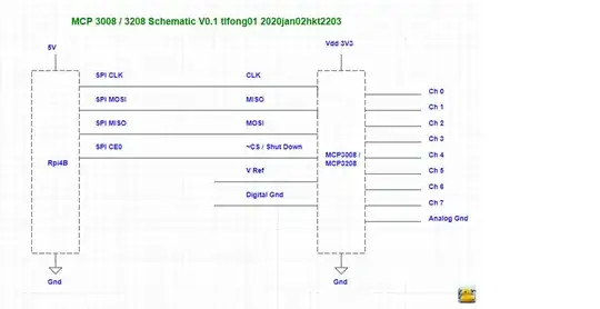

Now I am searching my old lab log to hopefull find something useful to suggest the OP to troubleshoot. I read my old schematic and found two things the OP might consider.
(1) Use separate analog grounds and digital grounds, as shown in the schematic below.
(2) Use a digital voltage reference with small series resistance, to maximize sample and hold capacitor current, so to prevent the not enough time filling up at high frequencies.
(3) Use one differential input channel, instead of single ended, to avoid noise problems. The three other not used differential inputs should be grounded, also to prevent noise, (ESD, back EMF) surge/spike problems.
(4) The schematic also reminds me that MCP3008's Chip Select (CS) pin is also used to "Shut Down". The Op might not be aware that there shutting down might need some time to wake up, otherwise the next conversion might not be accurate. This is just brainstorming, and I have not looked into this minor details for these particular hip, but I do have annoying experiences of not being aware that some chips's initialization and waking up take a long time, in the order of milliseconds.
mcp3008/3208 schematic 1
(5) One more thing is that the OP is powering MCP3208 with 5V. In this case Rpi 3V3 logic SPI signals should NOT directly drive 5V device. I almost always do not use directly Rpi's 3V3 GPIO/UART/I2C/SPI signals. I always shift up Rpi'3 3V3 signals to 5V (using TSX/TBX0102/4/6/8)

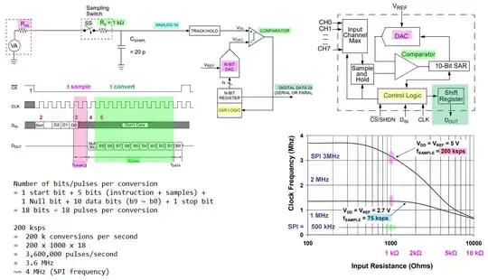

Part A - Datasheet spec summary
A.1 - max data rate = 20ksps (Errata - should read 200ksps).
A.2 - conversion time = 3 SPI byte transactions, or 24 cycles.
Part B - Circuit analysis
B.1 - Example Case 1 : SPI Frequency = 1MHz, => conversion time = 24us.
B.2 - Max sps = 1/24us ~= 40kHz.
B.3 - Conclusion: 1MHz means 40ksps is too high for MCP3008 to handle.
Errata - Conclusion is wrong. Max sps of 200ksps should imply max SPI frequency around 4MHz
Part C - Troubleshooting suggestions
C.1 - Suggest to lower SPI frequency from OP's 1.35MHz to 100kHz (Note 1) and test again.

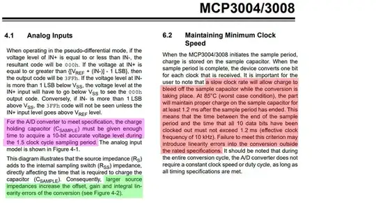

Notes
N.1 - Spec says min frequency > 10kHz, or sample and hold cap leaks.
N.2 - Volt source Rs < 1k, or sample and hold cap input current too small to fill up in time.
N.3 - Using SPI frequency might have a same trouble as N.2 above: sample and hold cap does not have enough time to fill up.
N.4 - My always dodgy calculation is not proofread.

*** Sample Output ***
''' >>> %Run adc_util_01_v111.py Begin program adcutil_01_v111 tlfong01 2020-08-12 13:40
   # *** Test MCP3201 ADC with Ref Voltage = 1.68V, and a range of SPI speeds ***
     Test Config: SPI Port = SpiPort00 ; ADC = MCP3201 ; Speed List = All speeds name list ; Sample Size = 10 samples
       SPI Port      Speed   Mean Raw  Mean Volt  Error (%)   Max Volt   Min Volt MaxMin Dif
      SpiPort00     10 kHz     0x07ff      1.650        1.8      1.652      1.646      0.006
      SpiPort00     50 kHz     0x0802      1.652        1.7      1.652      1.646      0.006
      SpiPort00    100 kHz     0x07ff      1.650        1.8      1.650      1.647      0.003
      SpiPort00    400 kHz     0x07fe      1.649        1.9      1.651      1.649      0.002
      SpiPort00      1 MHz     0x0803      1.653        1.6      1.655      1.650      0.005
      SpiPort00      2 MHz     0x07cc      1.608        4.3      1.608      1.604      0.005
      SpiPort00      4 MHz     0x06ce      1.404       16.4      1.406      1.404      0.002
      SpiPort00      5 MHz     0x0773      1.537        8.5      1.539      1.535      0.004
      SpiPort00      6 MHz     0x02ff      0.618       63.2      0.618      0.618      0.000
      SpiPort00      8 MHz     0x02ff      0.618       63.2      0.618      0.618      0.000
      SpiPort00     10 MHz     0x02e0      0.593       64.7      0.593      0.593      0.000
 End   program adcutil_01_v111  tlfong01  2020-08-12 13:40

    Wow, thanks for the answer. It inspired me to connect the raspberry pi ground to the external ground. Doing that solved the issue! – boileau Aug 07 '20 at 05:25
  • @boileau, How nice to hear that you have found the solution. By the way, I appreciate very much the way you present the problem concisely but still with all the necessary helpful details. It has been a pleasure learning problem solving with you. Have a great project. Cheers. – tlfong01 Aug 07 '20 at 08:19
    Thanks for the feedback. I'm hoping the shared ground bit helps someone else. My own googling didn't lead me to anything useful. – boileau Aug 07 '20 at 11:53
  • Yes, even your question with the detailed troubleshooting history help newbies a lot. BTW, I am finding more and more things that I didn't know that I didn't know, eg. how to by pass the reference voltage. So I am adding more troubleshooting tips from time to time. Have a great project. Cheers. – tlfong01 Aug 10 '20 at 08:52
