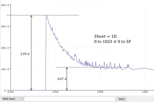

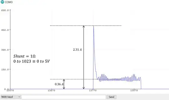

The Motor draws nearly 2.5A (Please see waveform) during start which according to L298N Datasheet is above maximum.
Waveform under no load waveform under no load
Loaded waveform when loaded

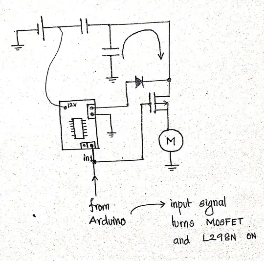

To prevent inrush, I came up with a circuit as given below. The capacitor would be charged at all times and the IRF740 MOSFET is set to turn on when the motor starts. The capacitor would discharge through the mosfet to provide the initial current requirement. Diodes prevent reverse current.
enter image description here I don't know if this would work or if this has any problems. Please tell me whether this circuit would work. If it has any problem, suggest a good method to prevent this inrush.

  • Ah, I found your circuit a bit confusing, and a bit problematic, even it works intermittently. Questions: (1) You seem to use a charged cap to drive the motor. How can you be sure the charge is enough to drive the motor? (2) You stared with L298N with 4 NPN BJTs and built in flybacks. But your question uses only one power MOSFET and the flyback does not seem to include the back EMF current path stuff. Perhaps you can show how you modify the L298N (or a part of it) and let us see the big picture. – tlfong01 Apr 16 '21 at 03:12
  • Your circuit cannot generate the correct Vgs values for that PMOS FET for one thing. –  Apr 16 '21 at 10:56
Use pwm from the Arduino to ramp up the power to the motor. No need for extra circuitry.
