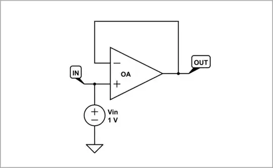

Thought experiment
To see the role of the op-amp gain, you can conduct a very useful mental experiment:
  • Imagine you can change the op-amp gain from 1 to 1,000,000 (this is a specially designed variable-gain op-amp for such educational purposes).
  • Make the simplest op-amp circuit with negative feedback - an op-amp follower.
  • Apply a constant input voltage Vin.
  • Vary the op-amp gain from minimum to maximum and observe how the three voltages (Vin, Vout and Vin - Vout) change. In the beginning, Vout = Vin/2 and Vout - Vin = Vin/2 (huge error). At the end, the difference will be negligible and Vout will be almost equal to Vin.

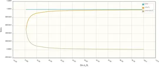

Simulation
Now let's do it with the help of CircuitLab running a DC sweep simulation with varying op-amp open loop gain OA.A_OL. To see the most interesting first part of the graphs, I have set a sequence of gains (1,2,3...10,20,30...100). As you can see, the error op-amp input voltage rapidly decreases from 500 mV (gain of 1) to 10 mV (gain of 100).
schematic
Graph A = 1 - 100

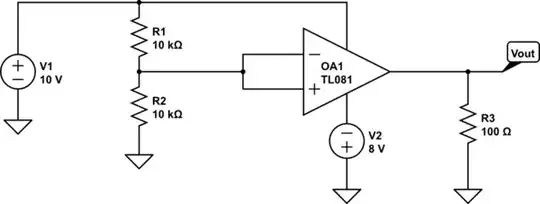

Other answers have adequately addressed the question of why the output voltage of an op-amp is non-zero, when the difference between the inverting and non-inverting input voltages is very small, or approximately 0. In this answer, I address the question of why the output voltage of an open loop op-amp is non-zero, even when the difference between the inverting and non-inverting input voltages is "exactly" zero, i.e. the inputs are tied together.
If the inverting and non-inverting inputs of an op-amp are tied together and held at some voltage \$V_{in}\$, the output voltage is some function of \$V_{in}\$ and the power rail voltages. That function depends on the type of op-amp as well as the individual characteristics of the individual device at the temperature it has at that moment, as well as the load on the output. Finally, even in a fixed environment, the output will undergo a transient modification. Practically, one should consider this output voltage to be undefined.
CircuitLab shows \$V_{out}\$ of the following circuit as 0. However, because we can treat the actual value as "undefined", CircuitLab's result is acceptable. In reality, the voltage is almost certainly some value other than 0.
schematic

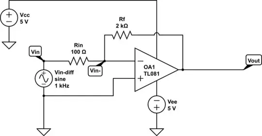

For example, in a simple inverting amplifier configuration we can calculate the gain based upon the feedback network resistances.
schematic
simulate this circuit
Using the open-loop equation above, we can calculate the closed loop gain \$A_{V}\$ as follows.
We assume that the current into the inverting input is 0,
$$\frac{V_{in} - V_{in-}}{R_{in}} + \frac{V_{out}-V_{in-}}{R_f} = 0$$
$$20{V_{in} - V_{in-}} + {V_{out}-V_{in-}} = 0$$
$$20V_{in} + V_{out} = 21V_{in-}$$
$$20V_{in} + V_{out} = \frac{21}{A_0}V_{in-}$$
Since \$A_0\$ is very large, we get
$$V_{out} \approx -20V_{in}$$
$$A_V \approx -20$$
That is the usual math that is presented. However, let's see what happens when we add some arbitrary value \$x\$ to \$V_{out}\$ in the open loop formula:
$$V_{out} = A_0(V_{in+} - V_{in-}) + x$$
Letting \$V_{in+}=0\$ and solving for \$V_{in-}\$ we get
$$\frac{V_{out}-x}{A_0} = V_{in-}$$
and if we now calculate the closed loop gain of our circuit, we get
$$20V_{in} + V_{out} = \frac{21}{A_0}(V_{in-}-x)$$
which again, since \$A_0\$ is very large, gives us the approximation
$$A_V \approx -20$$
So we see that,
the arbitrary offset that the open loop output voltage has from 0V, when the inputs are at the same voltage does not affect the closed loop gain of an op-amp circuit with negative feedback.
That is why the tutorials and simulators ignore this offet, even though it can easily be observed with an oscilloscope or voltmeter.
