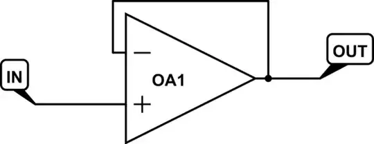

A super obvious example is a buffer:
schematic
If I put 1V in the input, the output tries to drive the inverting input to also be 1V. The voltage difference between the opamp inputs is then zero. Does this mean the output is zero? Clearly not because in this case the output is equal to the inverting input; And since the inverting input is equal to non-inverting input you have a buffer. Magical.
If you then start sinking the output to ground in the feedback loop through resistors or other components, then that saps away voltage from the output before it gets to the inverting input so the output has to be even higher to achieve a given voltage at the inverting input. Then you have an amplifier.

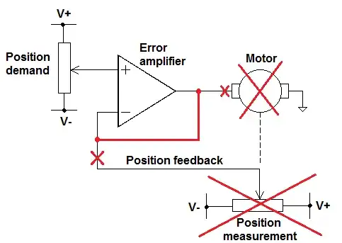

It's a control system; you set the demand on the non-inverting (reference input) and the output rises or falls to a level that makes the inverting-input equal the non-inverting input. Would a motor control system with an error amplifier cause you to scratch your head: -
Once you recognize that the op-amp (error amplifier above) is part of a control system, you can ditch the motor and feedback potentiometer and wire directly like this for a unity gain buffer: -
