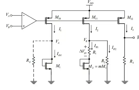

Before asking the question I would like to attach the image of the BGR regarding which I have some doubts:
From what I have read, due to the high gain of the op-amp, the two inputs of the op-amp, Va and Vb, are always at an equal potential such that the PTAT current flows across R1.
But, if the potential at the two inputs is equal, then shouldn't the output of the op-amp be 0 (or very close to it) as V0 = Av·(Vb-Va)?

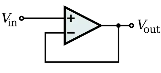

Yes, this is very true of any op-amp except ideal ones. It creates an error that sometimes can be annoyingly large. Consider an op-amp with an open-loop gain of 10,000 in a unity gain non-inverting circuit: -
Image from wiki.
If Vin is (say) 3 volts, we would expect the output to be 3 volts theoretically but, to get 3 volts at the output we need an input differential voltage of 3/10000 or 0.3 mV.
Because it's a unity gain amplifier, this means that the true output is not 3 volts but 2.9997 volts. That's at DC. At AC, the open-loop op-amp gain drops almost proportionately with frequency above the 3 dB point something like this: -
Image from here.
And, the impact of this is that the gain error gets larger with frequency. So, choose your op-amp carefully for your application and do an error analysis. Note also that for op-amp circuits with signal gain, you get an even bigger error.

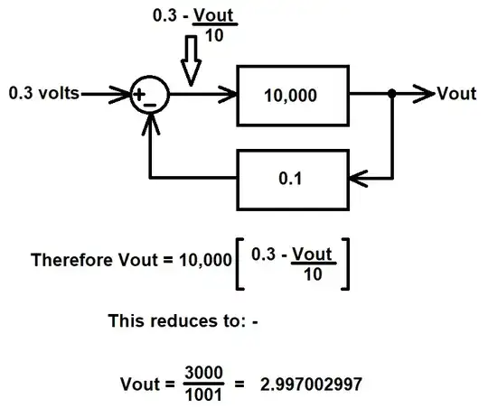

For instance, at DC, if the open-loop gain is 10,000 and you require a circuit gain of (say) 10, if you fed 300 mV at the input (hoping to get 3 volts on the output), the actual output voltage would be 2.997 volts (previously 2.9997 volts for a unity gain configuration): -
VA and Vb are, in general, only approximately equal, not exactly equal.
