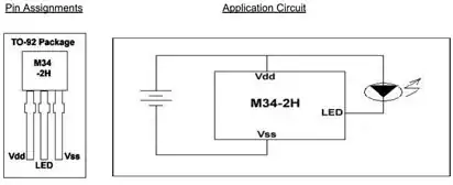

Bowin M34-2H is a 3-pin part that will flash an LED at 2 Hz with 25 mA current. It contains an internal RC oscillator, with +/- 20% tolerance, hence not terribly precise. The pin-out and application circuit from the datasheet:
M34-2H
This part offers 2 Hz at 1/8 duty cycle. Other parts in the series:
  • M34-1L or M34-1H or M2581 : 1 Hz , 1/8 duty cycle
  • M34-2L or M34-2H : 2 Hz , 1/8 duty cycle
  • M34-4L or M34-4H : 4 Hz , 1/8 duty cycle
  • M34-8L or M2585 : 8 Hz , 1/2 duty cycle
The H parts drive 25 mA, while the L parts are for 16 mA.

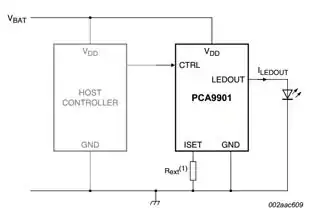

Alternatively, for programming of the flashing pattern, and even higher efficiency, the NXP PCA9901 is an option: Quiescent current < 0.75 μA!
This 8-pin TSSOP part can be "trained" with a sequence of up to 3 blinking elements, and will then continue to blink as trained. The programming connection can be removed after training, and this programming is achieved via a single signal line from any standard microcontroller, using the 1-Wire protocol.
PCA9901
The single resistor in the schematic sets the LED drive current, between 1 mA and 20 mA. It itself does not carry significant current (less than 1 μA), so will not drain the battery noticeably.
Given the choice, the NXP part would be a recommendation, both because it is from a major manufacturer, and because the blink pattern can be optimized down to 1/1024 duty cycle if needed, and cycle time varied across a wide range, covering the OP's entire blink-rate range of interest. Lower the duty cycle, longer the battery will last.

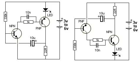

LED Flasher circuit
These schematics run on 3V, I tested it myself with BC547 and BC557 as NPN, PNP, respectively.
This does not require programming microcontrollers, ICs, it's just two transistor + some RC components. I bet you can get this in one cm^3!
By changing the RC values (play a bit with that, with a normal LED connected) you can adapt the frequency and duty cycle.
However, I have to warn you: CR2032 isn't the best battery you can get and IR is warm, so it uses some current. Let's say you blink the LED 20 times a sec and 20ms long. That makes it on for 40% of the time, giving you a resulting current of 40mA, quite a lot.
You can also use the LM3909, as Dave Tweed already mentioned.
    -1 for low-efficiency design. What's that 22 $\Omega$ resistor doing but making heat? At 100 mA you are burning almost 1/4 W there whenever the LED is on. That's more power than the LED! The blinking circuitry certainly draws some current, too. – Phil Frost Jan 07 '13 at 12:33
    True, trying removing the resistor is a good idea! Didn't make the circuit myself so I cannot change it. –  Jan 07 '13 at 12:35
  • If you remove the resistor, there won't be any current limiting. With ideal components, this means the universe explodes. With real components, this probably means you use the internal resistance of the battery instead. That, and the LED won't blink anymore. – Phil Frost Jan 07 '13 at 12:47
  • Okay, but that means the resistor has to be there, so what's your problem? –  Jan 07 '13 at 12:48
  • No, it doesn't have to be there. Look at my answer. No current limiting resistor there. Alternately, you could design it so the LED gets shorted to the battery, and let the battery's internal resistance (which is unavoidable) do the limiting. Olin's answer takes that approach. – Phil Frost Jan 07 '13 at 12:59
  • Yes, but that isn't simple anymore, with a micro. Well, we'll see what the questioner thinks. –  Jan 07 '13 at 13:00
  • so will this circuit work or not? I'm unfortunately not in a position to make an educated guess. – memyself Jan 08 '13 at 12:07
    @memyself Not very efficient, battery will not last long with this design. – ExcitingProjects Jan 08 '13 at 12:59

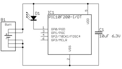

This is probably the simplest circuit:
Only 4 parts, and that includes the LED and the battery. (By the way, the only reason the battery looks so strange with 5 connections is because that's how the CR2032 battery holder I happen to have in my library works. The three negative connections are actually just solder bumps on the board.)
This is not a circuit I recommend for a industrial application where robustness is important. It plays fast and loose with some specs, but you asked for "simple". This sort of shortcut can be quite appropriate for a disposable consumer item, at toy, etc.
Note that there is no resistor in series with the LED. This is generally a bad idea, but as I said, this is a shortcut in favor of simplicity. A CR2032 battery has such high internal resistance that the current will be limited to what the micro and LED can handle in reality. The fact that the LED is a diode and its current goes down quickly at some voltage will help keep the voltage from collapsing to the point where the micro won't work, especially if the pulses are kept short.
For a better circuit, put a resistor in series with the LED. You can keep going and even put a small inductor in series followed by capacitor to ground to provide a short term local energy reservoir to run the LED off of during the pulses. This is then recharged more slowly during the off time. Going further, you can add a transistor that allows for more current than the PIC output can sink. There are lots of tradeoffs possible here to favor robustness and less battery abuse at the expense of more parts and less simplicity.
The PIC 10F200 is about as simply as you can get to make a digital oscillator. It's small, cheap, takes little power, you can have any kind of blink pattern you want, and timing will be accurate to a few percent. This is certainly better than a 666 timer.
If the point of this is to be a IR beacon, then you only need very short pulses with a low duty cycle. It's better to spend the energy on a short and bright pulse than a longer and dimmer one. The brighter pulse will have better range. For beaconing, you need to modulate the signal anyway due to the potentially high ambient level.

  • is there an alternative PIC that I could use? I don't seem to be able to find the 10F200. Would any 12FXXX or 16FXXX or 18FXXX do, or do I need a special one? – memyself Jan 07 '13 at 15:40
  • I assume it's easy to use a 8pin F200? http://ww1.microchip.com/downloads/en/DeviceDoc/41239D.pdf I guess it's a matter of connecting the GP0 to GO3 PINs accordingly? – memyself Jan 07 '13 at 15:53
  • @memyself: There at lots of PICs that can do this, but the 10F200 is the smallest and cheapest of them all. They are definitely readily available out there. I would start at microchipdirect, but surely many others carry it too. This is not a obscure part. – Olin Lathrop Jan 07 '13 at 17:34
  • No it will not. From the datasheet linked before: max 25mA current on any I/O pin, sunk/sourced. See section 12.0: electrical characteristics. –  Jan 08 '13 at 08:18
  • Haha, I sometimes need a sarcasm sign :-) –  Jan 08 '13 at 09:05
  • will this circuit work? the suggested solution seems to have gotten down-voted. – memyself Jan 08 '13 at 12:08
  • @AnindoGhosh so what are the ramifications? Sorry, but unfortunately I can't follow all arguments here :( – memyself Jan 08 '13 at 12:16
    @memyself This circuit will not be able to supply (sink) the 100 mA that you have specified for your LED. It will run the LED at 25 mA or thereabouts. If that is sufficient, there are simpler solutions available which do not even need a capacitor. Would you like a couple of such options? – Anindo Ghosh Jan 08 '13 at 12:21
    As I said, the circuit as shown plays fast and loose with some specs in favor of simplicity, as the OP asked for. 100 mA is absurd from a coin cell anyway, so it's pointless to worry about that. You can tie the three output pins of the PIC in parallel. I would have shown that if I had thought about it at the time. That would definitely make the CR2032 coin cell the limiting factor for LED current. – Olin Lathrop Jan 08 '13 at 13:27
  • @AnindoGhosh I don't think 25mA will make the LED light up. So I guess that's not an option. I could run the LED with the CR2032 for 4 hours so far and I really just want to extend the battery life to 8 hours or maybe 12 if possible. Hence the blinking. – memyself Jan 08 '13 at 15:44
  • @OlinLathrop please feel free to submit another solution! – memyself Jan 08 '13 at 15:44
  • @AnindoGhosh You'll find a link to the spec sheet in the first sentence of my question. Hope that helps! – memyself Jan 08 '13 at 16:07
  • @memyself According to the Radiant Intensity graph of the Characteristic Curves in the datasheet, the LED lights up fine at 10 mA. – Anindo Ghosh Jan 08 '13 at 16:12
  • @AnindoGhosh could you explain to me what figure you mean and how you see that it needs 10mA only? The lowest value I found in the spec sheets was 20mA. Many thanks! – memyself Jan 08 '13 at 16:34
  • @memyself Page 7 of datasheet, second image on left. This discussion has extended beyond what comments are meant for. The EE chat might be a better place to continue this. – Anindo Ghosh Jan 08 '13 at 16:46
