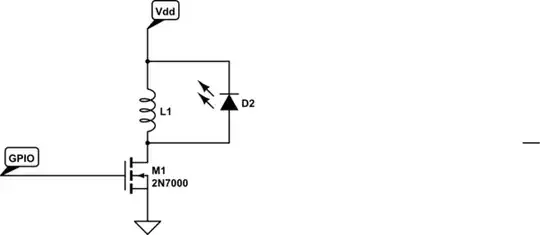

Roll your own converter, perhaps.
schematic
Pulse the GPIO high for long enough to charge the inductor to the desired peak current, then bring it low to discharge through the LED.
If the GPIO sticks on, the current is unlimited except by inductor DC resistance and MOSFET, so you may wish to degrade it a bit by adding a series resistor to handle such a case.
But in practical terms, I think you'll do very well by buying the LED with the highest brightness at a given low current and using a resistor.

    It might be useful to add that the drain voltage of the mosfet will rise above Vdd of a Vf. In case somebody wants to omit the mosfet, and directly use a micro pin for this circuit, it should be clear that that would not work due to the protection diode of the micro starting to conduct well before a significant current flows in D2. – Vladimir Cravero Dec 14 '18 at 14:19
