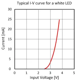

LED voltage curve From this webpage.
In my experience, LEDs glow with just a few mA.

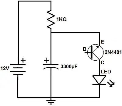

If you're asking what I think you're asking for, you need a simple timing circuit. The simplest timing circuit that I've come across so far is a relaxation oscillator. For example:
Relaxation Oscillator Built with a Transistor
Image source: Learning about Electronics - How to Build a Relaxation Oscillator with a Transistor
This, however, is not very reliable, and I've found it only works on a sunny day. You can however create a relaxation oscillator with a comparator:

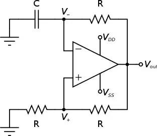

Op amp-based hysteretic oscillator, with the assumption of same-valued resistors
Image source: A comparator-based hysteretic oscillator from Wikipedia - Relaxation oscillator

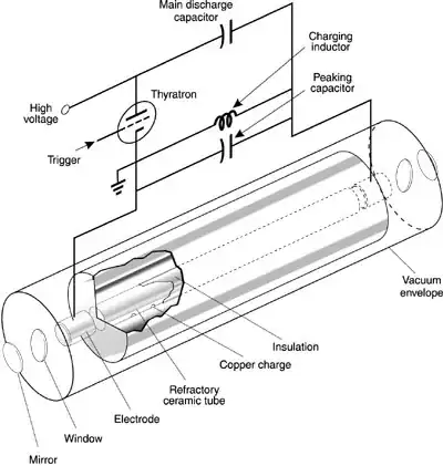

If you're looking for an oscillator out of only passive components, I can say it is very much in the realm of possibility. You'll need to spend a lot on high voltage power supplies; 6kV should do. The circuit is commonly used in gas lasers, and if proper safety precautions are taken, can be used in atmospheric air (though precautions should be taken, as UV radiation is emitted.)
Schematic diagram of pulsed copper vapor laser with basic power supply
Image source: Fig. 24, Schematic diagram of pulsed copper vapor laser with basic power supply from Module 4-2, Gas Laser Power Supplies
Just remove the thyratron, and tune the RLC accordingly. You can read more here.

    The IV (output) curve of the reverse connected transistor above should be S-shaped. It is interesting to see it. For this purpose, it should be driven by a current source. I will try to measure it with a simple IV curve tracer in the lab. – Circuit fantasist Feb 04 '20 at 08:47

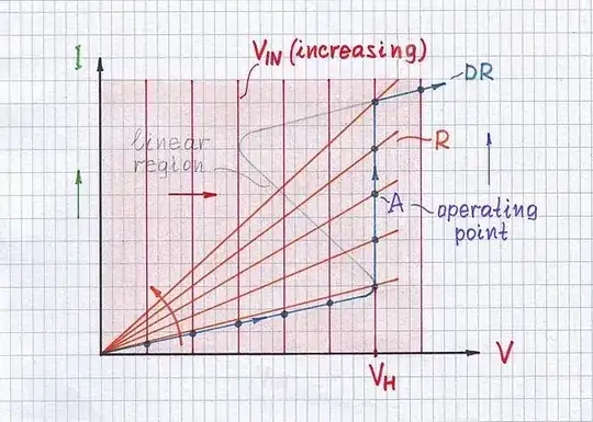

Increasing voltage (Fig. 1). Look at the IV curve (blue) of an S-shaped NDR driven by a voltage source (red). When increasing voltage reaches VH, the instant resistance decreases momentarily. Its IV curve (orange) rotates counterclockwise; the operating point A moves up ("jumps up") along the voltage source IV curve and pictures this vertical part of the curve. Thus during the jump, the current increases instantly (jumps up) but the voltage stays constant.

Fig. 1. S-shaped NDR driven by increasing voltage

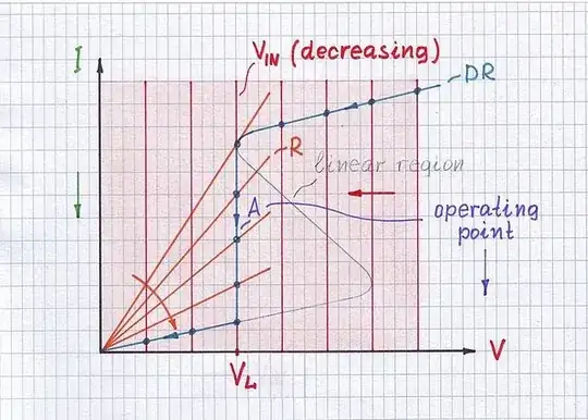

Decreasing voltage (Fig. 2). When decreasing voltage reaches VL, the instant resistance increases momentarily. Its IV curve rotates clockwise; the operating point A moves down along the voltage source IV curve and pictures this vertical part of the curve. During the jump, the current decreases instantly (jumps down) but the voltage stays constant.

Fig. 2. S-shaped NDR driven by decreasing voltage

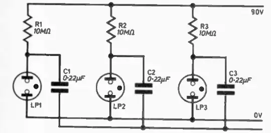

Why not use a neon?
I made a novelty flashing light years ago, which used an NE-2 neon lamp, a capacitor, and a resistor. Powered by a couple of unobtanium 67.5 volt batteries, it would flash every ten seconds or so. It did that for many years, until the batteries were exhausted. When the capacitor across the lamp reached the lamp's ionizing voltage, the capacitor discharged until the next cycle.
Perhaps you're speaking of the neon circuit presented in "Neon Novelty", by B.C. Macdonald, Everyday Electronics, vol 2 no 3, March 1973 (p60 of PDF).
I recently (2016) made one of these with eight neons. In place of the "unobtainium" 90V valve radio battery (eg B126) ... I used ten PP3 9V batteries. Works perfectly!
In 1973 I got a good shock off the B126 battery. I'm sure it's not advisable to let a 5-year-old child loose with a 90V circuit, but how you build it will make it safe or dangerous.
enter image description here Everyday Electronics, vol 2 no 3, March 1973, p140.

  • This idea is older; it is proposed by Pearson & Anson in 1922 - https://en.m.wikipedia.org/wiki/Pearson%E2%80%93Anson_effect – Circuit fantasist Feb 04 '20 at 07:15
  • @Circuitfantasist it was the questioner's phrase "novelty circuit" which is what reminded me of this particular article; of course a hobbyist magazine wouldn't be the original source. Thanks for the proper name though! – jonathanjo Feb 04 '20 at 09:01
  • I read the article with great pleasure... and warmth invaded my soul... How well it is described... with passion and enthusiasm... Only the main neon lamp property (hysteresis) is not emphasized - that after the lamp is lit it "memorizes" this state until the voltage across it drops to the lower threshold. I'm trying to imagine how the full multistage circuit works... a big challenge to my imagination... – Circuit fantasist Feb 04 '20 at 10:36
