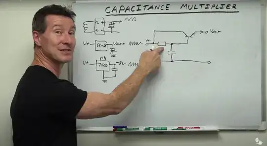

For a clean output voltage, I would suggest you to use a "capacitor multiplier" before LDO in your circuit. According to my tests, it can reduce noise to a level of 15mVpp. It is basically used where ultra-low noise is desired like in Current sense Amplifier. Please watch this video to implement it in your application.
Best of Luck
Deepak

  • I Saw this and tried simulating it but i could not get it to work See picture the output voltage dips to basically 0 . – DrakeJest Oct 03 '20 at 15:46
  • Thanks for the trial @DrakeJest, actually for 5V MOSFET will not work as the threshold voltage for MOSFET is higher. But the Transistor solution will work. You have to choose R3 register so that current through the transistor base =( Load Current)/(Beta of the transistor). in your case use 100ohm as R3 and 100uF C2 Capacitor. – Deepak Oct 03 '20 at 19:02
