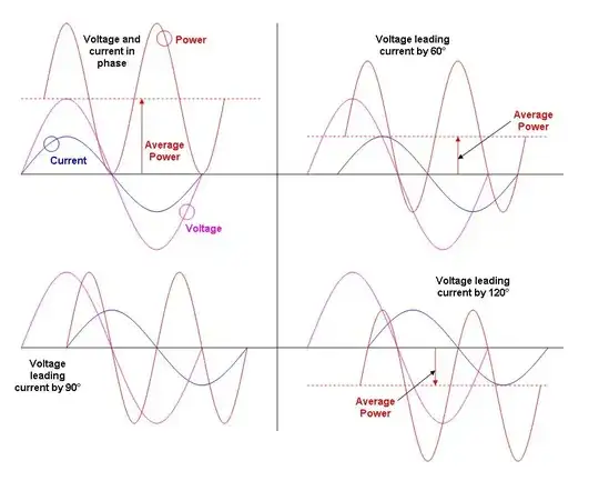

For instance, here is a pictorial example from this answer: -
  • In red above are instantaneous volts × instantaneous amps (true power)
  • I've also indicated the average power (red) in all the examples
  • In all cases, RMS volts × RMS amps is the same value
  • Top left shows a resistive load and produces true watts
  • Top right shows a reactive load and clearly, the average power is smaller for the same applied RMS values of current and voltage
  • Bottom left shows the case where the load is wholly reactive and the average power is zero despite the RMS values of voltage and current remaining the same.
  • Bottom right is when the phase angle has moved so much, the "load" is now supplying power to the source.
The take-away thing here is that RMS voltage × RMS current is the same for all scenarios yet, only in the top left does RMS voltage × RMS current = true power.
Hence, we call the value of RMS voltage × RMS current "apparent power" and, we define its units as volt\$\cdot\$amps and not watts.

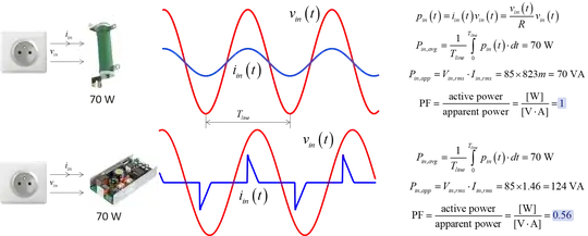

For an introduction to power factor and see the difference between apparent and average power, you can have a look at my latest tutorial on PFC. This first illustration shows the difference between average power which contributes the work in the physical sense, e.g. luminous flux, audio sound etc. and the apparent power actually produced by the utility company or the generator:
When you power a resistance, both current and voltage are in phase. Apparent and average power are the same and the utility "sees" 70 W to power. When you now power a nonlinear load such as a full-wave rectifier, absorbing the same 70-W average power as the resistance does, the utility will have to deliver more apparent power and a higher rms current will now circulate as determined by the formulas. Part of this extra current circulates and heats up the wires but does not participate to the work. You can find further explanations in this clear article.
