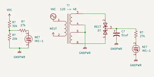

I am designing a Nixie tube clock and need to power some INS-1 neon bulbs. The bulbs have a striking voltage of 65 - 90 V and an operating current of 0.5 mA.
To power the bulbs should I divide 170 V to 68 V using a voltage divider (left) or should I step down 120 VAC to 48 V and rectify that to ~68 VDC (right)?
In the final design the circuit will be powering two blinking neon bulbs. Since I am dealing with mains and am fairly new to electronics, I thought I should probably ask here before testing these designs. Any suggestions are appreciated.

You don’t need or want to divide down the voltage. Neons will work fine from the full voltage, provided you adjust the resistor value to limit the current to the recommended range. They’re a bit like LEDs in that regard, except if they don’t get enough voltage to begin with they never light (and that voltage increases with age, and is higher in the dark).
So (170-68)/0.5mA is about 200k ohms.

As an alternative, consider a stack of ten 9V PP3 batteries in series. I made a replacement for a 90-V B126 valve radio battery this way: easily obtainable and has worked for years.
If nothing else, it's a good way to test your neons before you build the mains circuit.

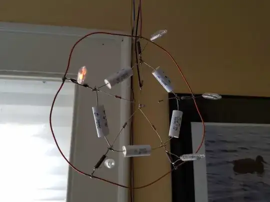

I use a pair of 48V "wall warts" in series (with a 33kΩ resistor between them to limit the current to a very safe level) to power this thing:enter image description here
