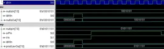

If I simulate this as it is, the mc module loads a clock cycle early (seeming to infer a latch):

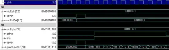

But if I comment out the shift register, else if srPIn, line in mp (effectively making them the same), then mc loads at the correct time:
My question is, why are changes in one module seeming to affect changes in another? Am I hitting some weird optimization area? Why am I inferring a latch where I shouldn't be? This seems to follow the correct rules for writing a register.

The above example allows for a race condition in the Verilog scheduler. ldMIn and clkIn become one in the same time step, but the assignment and evaluation order is not deterministic. In your first waveform, ldMIn is being assigned before mc is triggred by the @(posedge clkIn) which is why multicOut is updated immediately. In the, in the second waveform the scheduler happened to reverse the order.
The Verilog language specifically allows non-determinism (up the to the vender how to implement). Making it your responsibility to enforce determinism when needed. The easiest way to do this in the test-bench is to use non-blocking assignment for synchronous data, just like RTL does. (See Blocking vs Non Blocking Assignments )
Assigning ldMIn and other non-clock synchronous signals with non-blocking should fix your issue. I would highly suggest one additional change; delay the assignments relative to @(posedge clkIn) instead of # delays. Doing so forces any assignment to be after the clock update and allows for easy scaling with the clock frequency.

It looks like you are changing your input values and the clock at exactly the same time, although we would need to see your testbench to be sure. That's a dangerous thing to do in real life or in a simulation. Try moving the changes in the input values by about a quarter of the clock period, after the rising clock edge.
