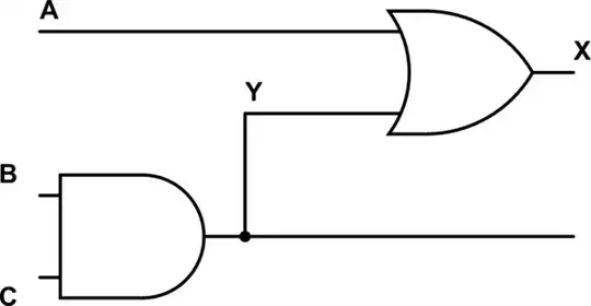

This is more of an addendum to pre_randomize's answer, but as comments do not allow for images I am posting as an answer.
The general rule of thumb, as already stated is:
Use blocking (=) for combinatorial logic and non-blocking (<=) for sequential (flip-flops)
The D flip-flop chain is a good example of how using the wrong assignment (in this case a blocking assignment for sequential procedures) creates simulation results inconsistent with synthesized logic.
The flip side is if you have multi-level combinational logic, as shown below:
schematic
In this case, if we were to write this as two separate lines for outputs X and Y, we would write:
Y = B&C;
X = A^Y;
Which makes sense, Y is first becomes B*C and after that, X becomes A+Y. Note that there is implicit ordering because of the way the gates are drawn, the AND gate resolves before the OR gate because a wire goes from the AND gate to the OR gate.
Consider what you are describing if you write the following:
Y <= B&C;
X <= A^Y;
In this case, we are saying Y becomes B*C simultaneously with X becoming X+Y (within the same time-step). This means that a simulator will evaluate Y with the previous (last time-step) values of B and C (not a problem) but also X with the previous values of A and Y (potentially incorrect).

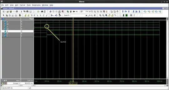

I have found a satisfactory answer and need input for it. I feel we should use Nonblocking statements for both combinational and sequential statements.
For sequential it is pretty clear y we should use.
I will describe the reason for Combi Blocks.
For eg. take the following code
module block_nonblock(output logic x,x1,y,y1,input logic a,b,c);
always@* begin : BLOCKING
    x1 = a & b;
    x  = x1 & c;
end
always@* begin : NONBLOCKING
    y1 <= a & b;
    y  <= y1 & c;
end
endmodule
Here the same hardware is inferred for both the circuits.
Simulation waveform depicting glitch
However, if we give the inputs together as (A = 1,B = 1,C = 0) and then change them together after say 10ns as (A=1,B=0,C=1) then we can see that there is a glitch. This glitch will be there in actual Hardware as well. But this is only shown in simulation by Nonblocking Statements Output (Y) and not by Blocking Statements Output (X).Once we see a glitch we van take additional measures to prevent this from happening, so that it doesnt happen in hardware.
For combinational segments we will use Nonblocking Statements because, when we use Blocking or NonBlocking statements, even though it gives us the same hardware or RTL in the end; it is the nonblocking statements which shows us the glitches in simulation. Theses glitches will be there in hardware as well (because of Gate Delays), so we can rectify them when we see them in Simulation so that they will cause less harm at a later stage of the design/development cycle.
Hence i feel it is safe to conclude that we must use Nonblocking statements for combi blocks.
  • When you use nonblocking statements for combinational blocks, the output you observe in simulation will be wildly different what you would observe from the synthesized circuit. It is true that both the circuits synthesize to be the exactly same, but the presynthesis simulation and postsynthesis simulation would differ (basically you are just simulating the wrong circuit, and synthesizing the right one. Does not mean that the output will be the one you saw in simulation). Basically, you are designing the entire circuit wrong (because you are simulating it wrong). – ironstein Apr 07 '16 at 18:17
  • Hi @ironstein , could you you elaborate with respect to the above circuit. I didn't understand y you termed it as wrong. My intention is to make a 3-input AND gate using 2-i/p AND Gates., and decide which statement(Blocking or Nonblocking) would be best. Isn't the above circuit doing the same thing(3 i/p AND Gate). How is the circuit wrong..? What am i missing here...? – Edwin Joseph Apr 11 '16 at 06:42
