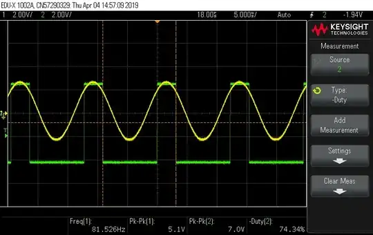

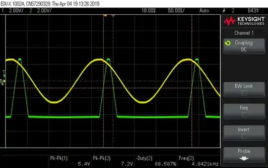

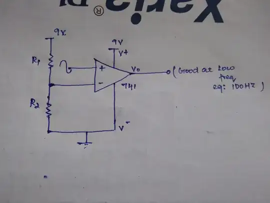

So I first tried to compare the sine wave with a reference voltage (2.2 volt). Sine wave amplitude = 2.5 volt (5 V peak to peak) and frequency 100 Hz and 5 kHz.
Enter image description here
  • At low frequency (say 100 Hz), the output is good
  • At high frequency (say 5 kHz), the output is too bad.

  • It looks like there's a significant lag/delay in the output's response w.r.t. the input signal (~30µs?). What may be causing this? What's connected to the output? 'Scope probe only? – JimmyB Apr 05 '19 at 11:00
  • For 5Khz i thought 741 will be ok, for what i calculated .Orelse sure i will change the opp amp which having high slew rate and i will update it.......@JRE – Bud Apr 05 '19 at 11:26
  • Yes i used the scope probe only at the output. I don't know which causing this error.......@Jimmy – Bud Apr 05 '19 at 11:28
    You're latching up. – Scott Seidman Apr 05 '19 at 12:34
    Note that this question is about the theory behind the calculations. Telling OP to change his OP-amp does nothing to answer the question. It just solves the problem without OP knowing why. – pipe Apr 05 '19 at 19:58
  • If not latching you are at least saturating and the recovery takes time. A 741 is a poor comparator and an OP-AMP over driven rail to rail is not able to operate to small signal design specifications. You are also at the low end for 741 supply headroom. – KalleMP Apr 05 '19 at 20:13
  • The slew rate of a square wave is infinite. So a slew-rate limited op-amp will not put out a square wave. It will put out a "trapezoid" wave, which is what you are seeing. The question you should ask is, does the slew rate of your trapezoid match the specification? Looks like not. It is too slow by far. But I just wanted to point out that your frequency calculation is really not applicable when the expected output is a square wave. – user57037 Apr 08 '19 at 09:12

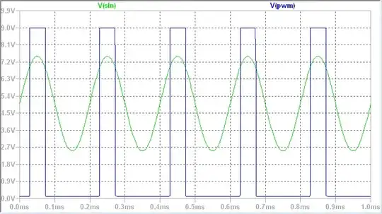

Here is what can be achieved with the venerable LM393 at 5kHz. The shown circuit will work even up to about 50kHz before the delay of the LM393 starts to distort the PWM duty cycle.

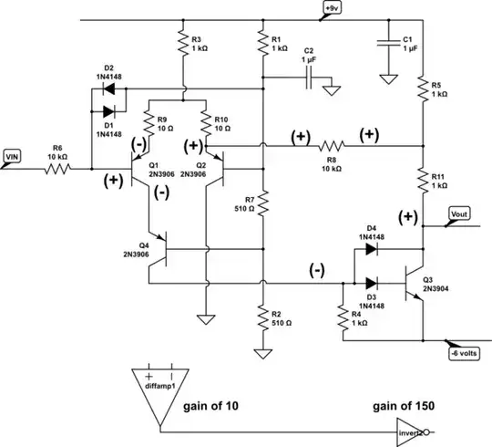

[modified to run on +9/-6 volt rails] You may try this, if you want a discrete solution. The delay, without input protection resistor, should be about 20 nanoseconds.
schematic
The speed will be limited by Rin (10Kohm) and a minimal Miller Effect Cin (20pF?), thus propagation delay will be about 0.2 us (200 nanosecond).
