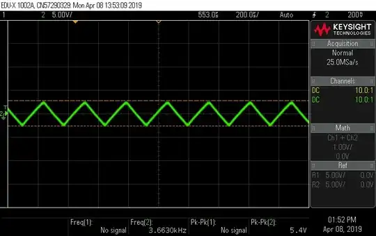

Input waveform before connecting to a comparator
Offset voltage = 0 volt enter image description here

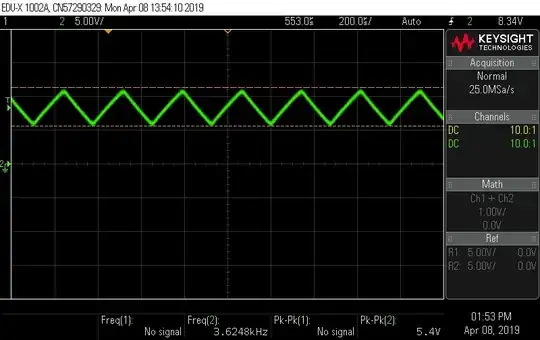

Input waveform after connecting to a comparator
Offset voltage = 6 volt enter image description here
How to compensate the offset voltage to zero volt after connecting with comparator.

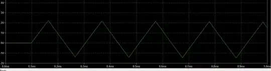

Circuit.. Triangular Waveform... enter image description here

Without connecting with comparator enter image description here
