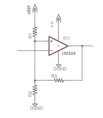

You can make most op-amps act like it has Schmitt trigger inputs by adding hysteresis.
The advantage here is you can set the trip points to be anything you like. They are controlled by the three resistors R1, R2, and R3. Here is the formulae used:
$$Vh =\frac{Vs*R2}{\frac{R1*R3}{R1+R3}+R2}$$
and
$$Vl = Vs * \frac{\frac{R2*R3}{R2+R3}}{R1+\frac{R2*R3}{R2+R3}}$$
Vs is the reference supply. Vh is the upper threshold, and Vl is the lower threshold.
Here are the same formulas suitable for input to a spreadsheet if you want to experiment with the values:
= ((A10*A2) / (((A1*A3) / (A1+A3)) + A2))
= A10 * ((A2 * A3) / (A2+A3)) / (A1 + ((A2*A3) / (A2+A3)))
where A1..A3 are the resistor values R1..R3, and A10 is the reference supply.

  • So you cannot set adjustable trigger levels in Schmit Trigger? – user16307 Mar 27 '15 at 15:46
  • Well I was wrong. I though you could get op-amps with preset hysteresis. I'm unable to find any. You can get logic gates with Schmitt trigger inputs -- e.g. 74HC132 but not apparently op-amps unless someone else knows of one. So you have to use external resistors as shown above, which do allow you to precisely set both high and low trigger points. – tcrosley Mar 27 '15 at 16:28
  • Not any op-amp. For instance, TL084 can (depending on the input) exhibit phase inversion in this very configuration. – Peter Mortensen Apr 03 '15 at 15:37
