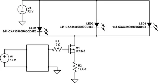

When I control brightness using DC power supply, the brightness varies properly (from 0 to 50K Lux) with voltage. I used a MOSFET and the brightness varied from only 18200 to 18900 Lux when duty cycle was varied from 0 to 100 %.

The 12 V supply is input to the microcontroller board I use. Didn't know how to add a microcontroller board in the schematic. So just drew a block to represent it.
schematic

  • Added the circuit diagram. – Santosh Mar 28 '19 at 14:41

  • That is a horrible, sideways diagram. Make it horizontal and take a few minutes to draw and write it more neatly, or use the built in schematic editor to provide your schematic. When you do these diagrams, sources are left, loads are right, higher voltage up and lower voltage down, you got that right, but also try to position things so the purpose is clear, and choose which lines cross based on that. Put the LEDs, switch and resistor in series vertically so their purpose is obvious, which brings me to my point: It appears you have 10k$\Omega$ in series to the LEDs, so at 12V, 1.2mA max. – K H Mar 29 '19 at 00:02
  • I have added the schematic. I hope it makes more sense – Santosh Apr 06 '19 at 14:28
  • The empty box represents the PWM microcontroller board. Don't know how to show it in the schematic. – Santosh May 01 '19 at 17:00

In your schematic, you are driving a 72V, 2A LED from a 72V power source. When the FET is ON, the current is going through the LED, through the FET, and through R2 to ground. So, how much voltage is dropping across R2 during this time? I honestly don't know, since I don't have the data sheet for these LEDs, but I imagine it's not very much since the LED wants such a high voltage to turn on. If it were 1V, that's only 0.0001 A going through the LED.
Also, since FETs are voltage controlled, not current controlled like BJTs, you don't need a current limiting resistor going to the gate (R1). You can put one there for basic isolation, but it should be much higher (1k ~ 10k). You DO need a pull-down resistor pulled to ground at the gate to keep the FET OFF when the signal at the gate is low. This should also be (1k ~ 10k). If you do use a resistor between your driver and the gate, this pull-down should be on the driver side so you don't create a voltage divider at the gate.
I sincerely hope you are NOT doing this on the output of the motor driver. Those are pins designed to drive current to a motor, not what you are trying to do. If this is the case, you've likely destroyed the MOSTFET gate with the excessively high current output. All you need is a basic MCU output pin and a "logic-level" MOSFET, of which the FET linked in one of the comments is (meaning it can "turn on" at a lower logic level - look for the "gate-source threshold voltage" or Vgs parameter in the datasheet).
