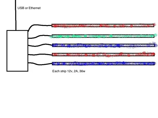

I am attempting to build/create/design/whatever a way to control my RGB LED strips via a USB or ethernet interface. These strips consume a lot of power and the mass produced controllers suck. I would also like independently controllable "zones" if you will, so ideally this device could power 1 or more strips.
Since a picture is worth 1,000 words I've attached an image of what I am trying to accomplish. Does anyone know of something like this commercially available, or how I can practically create something that will power this many LEDs? At a minimum I would really like each device to power 3 strips at a time which is quite a bit of power. I'm am very new to EE, so this is all kind of overwhelming to me.

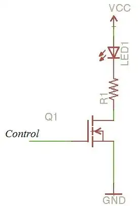

A very common way to control the LED brightness is by using Pulse Width Modulation. To drive a large current, a transistor is commonly used as such:
MOSFET LED Switch
In this circuit, the MOSFET (Q1) is being used to switch the LED to ground. This would be ideal for the common anode RGB LED as each internal LED should have its own cathode. The brightness is controlled by pulsing the base of the MOSFET. This pulse should be high enough to avoid any noticeable strobe. A safe number is 200Hz. The duty cycle of this pulse (the ON time vs the OFF time) then controls the brightness of the LED. The resistor R1 is necessary to limit the current through the LED.
Here is a discussion on efficient ways of driving LEDs such as a current driver.
If you want all of the LEDs to be the same color, then you would need three of these transistor switches and three PWM outputs with every red, green, or blue cathode (plus current limiting resistor) in parallel.
You could divide the control up as much as you like to set different LEDs to different colors at the same time. The PWM output can be created manually in software, or done automatically using the microcontroller's dedicated internal hardware functionality, although the number of dedicated internal PWM channels is limited in a device. Software versions are limited by the total number of I/O pins unless you resort to using I/O expanders or shift registers to increase the number of outputs available. There are also numerous multiplexing schemes, but they can become overly complicated.
Choosing a Suitable MOSFET
There are a couple of important things to note about picking the right part:
  • Drain to source current (I_ds) - this is the maximum current that can be switched. Give yourself plenty of overhead room!
  • R_ds(on) - this is the MOSFET resistance while it is saturated (switched on). The lower this value is, the more efficient the switch will be (less power dissipation in the switch)
  • Gate Threshold voltage - this is the minimum voltage necessary at the gate for the MOSFET to start conducting. It needs to be a bit higher than this to be fully saturated. For control from a microcontroller, you will want a "logic level gate" which has a very low gate threshold voltage. The R_ds value will drop as the gate to source voltage increases.
  • Power dissipation - The MOSFET will need to be able to dissipate at least the expected current (I_ds) squared times the expected drain to source resistance (R_ds).
It is also a good practice to put a pull down resistor (10k or so) at the MOSFET gate to make sure it is OFF when you want it to be (such as during a system reset).

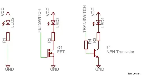

For USB I'd use one of the AVRs with hardware USB (like the ones on teensy, leonardo, etc). Have the PWM outputs driving logic level MOSFETs. (assuming you want to control brightness... but that will do on/off too).
The mosfet will sink the current (be connected to the ground side of your strips, with +12 to the other side of the strip).
Like the middle portion of this drawing, except the resistor and LED are integral to the strip, so the strip would be wired in here.
mosfet diagram
You'll need a mosfet that will be on with 4-5V, capable of a couple amps, and 20V or so. more current/voltage handling never hurts, though. Low Rds will help efficiency. (per channel).
