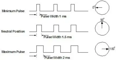

Hobbyist Servo Motor
This type of servo motor has an internal potentiometer that provides feedback to internal circuitry as the motor shaft turns, thus allowing it to turn to a know position. You control the motor by sending it very specifically timed pulses. Servo motors I've worked with want a 50Hz signal, so a pulse every 20 milliseconds. This pulse is used to create an analog value in the servo driver that is compared to the value coming from the potentiometer. That's how the servo knows to stop at the correct position.
The pulses themselves control the rotational position of the motor. The working range is typically 1000 to 2000 microseconds (1 - 2 ms) with the center position (90 degress) right in the middle at 1500 us. Some motors have a bit of an extended range [0.5, 2.5us]. See this image from Jameco:
Servo motor pulses
