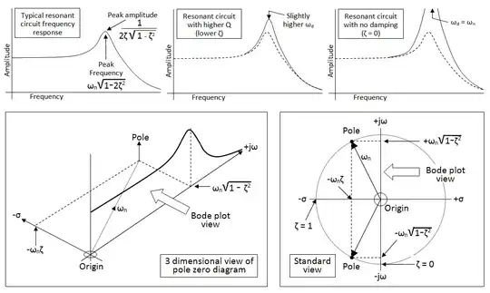

Here's a bit of a crash course in poles: -
The upper pictures show a bode plot with frequency peaking in various amounts. The lower left picture attempts to show a 3D view of bode plot and poles and the lower right picture is the conventional pole zero diagram.
In other courses in which we deal with Bode plots, I notice that a pole causes a -20dB/decade slope decrease? Why is there an incosistency?

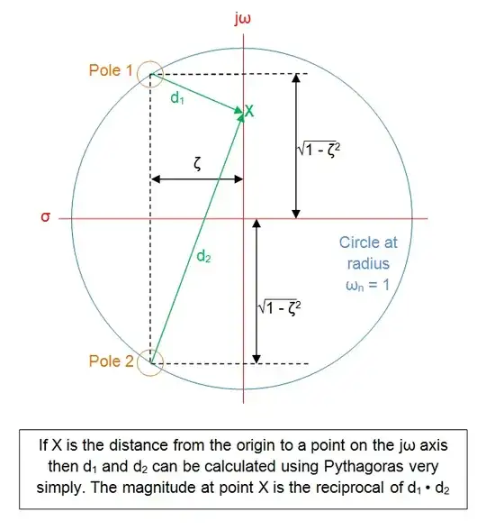

There is no inconsistency; a single pole causes a peak in the spectrum and, due to the mathematical relationship (1/distance) between the pole centre and more distant positions on the jw axis there is a slope that results.
For a 2nd order low pass filter (example) there are two poles and the reciprocal-of-distance relationship leads directly to the ability calculate any point on the jw axis: -
Hope this helps. Related question and another related question and yet another related question. And another.

  • Oh wow. That 3-D diagram made so much sense. Thank you so much. Just one more thing, in regards to the resonant frequency. I know that for a second-order cannconical system, there is a value for the resonant frequency based on the damping ratio. Now, does that mean that only one frequency in a system can ever cause a resonance? If so, where does the entire pole stuff come into then? Or is there a damping ratio associated with each pole? – AlfroJang80 Nov 20 '18 at 12:50
  • Both poles in a 2nd order filter have the same damping ratio as shown on the horizontal axis on the bottom right image. The value of resonant frequency is (or can be) independent of damping ratio. – Andy aka Nov 20 '18 at 12:55
