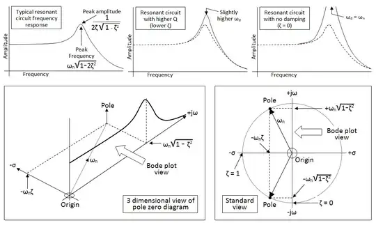

The question assumes there is one damping factor i.e. the transfer function is dominated by a 2nd order system. In practice there could be several interacting 2nd order systems so care has to be taken here.
Assuming it is dominated by a single 2nd order system, this diagram may be useful: -
This picture allows you to calculate \$\zeta\$ by looking at the peak amplitude value in the bode plot. From this you can calculate \$\omega_n\$ using the 2nd formula. Once \$\omega_n\$ is known you can double check the value of Q (1/2\$\zeta\$) because, for a 2nd order filter like this Q IS the magnitude of the amplitude response at \$\omega_n\$.
Here's the bigger picture showing how the bode plot and pole zero diagram are related: -

  • Thank you for answering. What about higher values of $\zeta$ where diagram has no peak value? – SMA.D Jul 14 '16 at 08:48
  • I don't know what you mean. – Andy aka Jul 14 '16 at 09:55
  • The 5th diagram that you showed has no peak. (You have marked it "amplitude Q at $\omega_n$") – SMA.D Jul 14 '16 at 11:00
  • Oh yes it does have a peak - look carefully along the 0dB line (Q=1) at about 0.7$\omega_n$ – Andy aka Jul 14 '16 at 11:03
  • Just another question, what is the $\zeta$ values in the 5 plotted diagrams (just to compare the order of peaks for different cases). – SMA.D Jul 14 '16 at 11:13
  • Convert the dB scale to a real ratio at $\omega_n$ to give Q. So the next one up occurs about 3 dB hence Q = 1.4142 and zeta is 1/2Q or 0.354. The top trace peaks about 24 dB up hence Q is about 16 and zeta is 1/32 or 0.03. Also take note that there has to be a recognizable peak or the formulas become "out of bounds". – Andy aka Jul 14 '16 at 11:36
