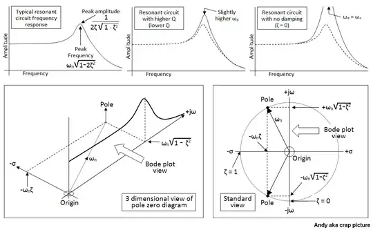

As most folk know, \$s=\sigma+j\omega\$ (where \$j\omega\$ is the frequency along the x-axis in a bode plot or spectrum analysis). However, in a bode plot, \$\sigma\$ has no apparent meaning but it is actually the "unseen" z-axis (in and out of the screen/page).
If the natural resonant frequency of the RLC circuit were 1 radian per second then the z-axis is purely zeta, the damping ratio. That's the simple answer. The fuller pictures (hopefully) should be apparent with this image showing example bode plots along the top and the pole zero diagram in 3D at left bottom: -
As you should be able to see, the "z-axis" (or \$\sigma\$ axis) has values corresponding to \$\omega_n\$ (the natural resonant frequency aka \$\frac{1}{\sqrt{LC}}\$) and the damping ratio zeta (\$\zeta\$).
s is supposed to be sigma + jw, and sigma arises so that the transform integral converges. However, when constructing bode plots, this is completely ignored. Why?
Hopefully you can see that now.
Is there a physical meaning to sigma?
Basically it's damping ratio multiplied by natural resonant frequency for values of zeta between 0 and 1.

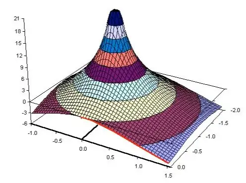

Think like this - you have a table and on that table you stand your pencil upright in the middle (this is the pole). You then place a really thin and pliable handkerchief over the end of the pencil. The contour made by the handkerchief produces a tent effect but more perfect: -
At any point from that pole position, the handkerchief has a numerical value that is perfectly defined. For instance, if you draw a circle around the pole, all points on the handkerchief would have the same amplitude. If the pole is at -1 then, the amplitude when s = 0+j0 (the origin) is 1. The amplitude at 0+j1 needs a little more thought - the distance from the pole to 0+j1 is 1.4142 therefore the amplitude is the reciprocal of 1.4142 i.e. 0.7071 (aka the 3 dB point of the simple RC filter your numbers numerical example describes).
At 0+j2, the distance from the pole is \$\sqrt{1^2+2^2}\$ = 2.236 and the amplitude is therefore 0.4472.
At 0+j10 (ten times the 3 dB frequency), the distance is \$\sqrt{1^2+10^2}\$ = 10.05 and the amplitude is 0.0995.

    This is a fair comment but it cannot be infinite because harmonic analysis implies that sigma is 0. To see the magnitude going infinite with your expression, you would need to explore the entire left half-plane $s$-plane and it has no physical meaning. In a Bode plot, you only explore the vertical $j\omega$ axis (like with a sinewave in the lab). However, imagine two conjugate poles located in the vertical axis (no real part, undamped system) then when $s$ reaches resonance, the magnitude is approaching infinity as shown in Andy aka's upper right graph. – Verbal Kint Jul 12 '17 at 16:32

  • @anhnha the 3dB frequency is very much dictated by zeta and can extend well beyond wn when zeta is small. But it really depends on what you define as the 3dB point - is it 3 dB below the peak or 3 dB below the DC gain? What can be said is that at wn, the bode gain is Q but i don't know if this helps? – Andy aka Jul 13 '17 at 15:13
  • Yes, you are right. I shouldn't call it 3dB frequency. What I wanted to say is in the Bode plot, the breakover point is wn (natural frequency) and it is the intersection point of two asymptotes as in the siles (page 42, Magnitude asymptotes, quadratic form). In your 3 dimensional view of pole zero diagram above I thought that wnsqrt(1-zeta^2) is the breakover frequency. Just want to confirm again, in the Bode plot by asymptotes, is the breakover frequency point is wn not wnsqrt(1-zeta^2). Is that right? – emnha Jul 13 '17 at 20:06
  • I don't have Siles and I'm unsure what you mean by break over frequency. If you mean the frequency where the maximum peak occurs look at my picture that shows the 3D and look top left for the peaking frequency and amount of peaking. Like I say I'm unsure what you mean. I will also add that you can't be exact about wn from the bode plot magnitude response. – Andy aka Jul 13 '17 at 20:14
