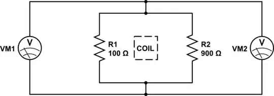

In this video, the electrical engineer and youtuber Mehdi Sadaghdar (ElectroBOOM) disagrees with another video from professor Walter Lewin.
Basically, professor Lewin shows in an experiment that if we have two different resistances connected in a closed loop, and if we generate a changing magnetic field using a coil, the voltage at the endpoints of the two resistances will be different, contrary to the expectations from Kirchhoff's Voltage Law (KVL).
schematic
According to the experiment, the left voltmeter VM1 shows a voltage different from the second voltmeter VM2. Lewin then concludes that KVL does not hold when there's a changing magnetic field. The mathematical reason that he gives is that the magnetic field is non-conservative, and KVL can be derived from Maxwell's equations only when the field is conservative. He then says that this experiment is a proof of his claims.
Mehdi, on the other hand, points out two things: first, that the way the probing was done is incorrect. The changing magnetic field has an effect on on the probe wires, and that's one of the reasons why the voltmeters change value depending on the position.
Second, he says that because there's a loop, then the loop is behaving like an inductor, and together with the coil it's forming mutual inductor:
schematic
simulate this circuit
I understand Lewin's derivation of the KVL, so I understand that there's an issue with the non-conservative magnetic field, but at the same I think Mehdi is right: that loop is an inductor, and the way Lewin is probing the circuit looks wrong to me. So where is the mistake here?
  • Does KVL hold in the circuit above?
  • Is the probing being done right?
  • Does the circuit have a mutual inductor that should not be ignored?

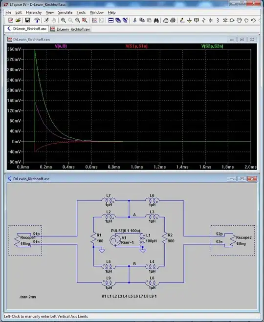

The lumped component models to which KVL is applied are just that--models. Like all models, they are only accurate to the extent that they represent the relevant characteristics of the system they reflect. The simple loop of two resistors model does not represent the susceptibility of the conductive path that constitutes the circuit to induced EMF, therefore this simple model will not reflect the behavior of the real circuit in the real world where induced EMF is a thing that happens.
The simple model can be made more accurate by including inductors between the resistors and an additional inductor that represents the solenoid that provides the changing magnetic field. By considering the coupling of these inductors it is possible to incorporate the induced EMF into the model and thus achieve results that better reflect reality. A reasonably complete model of the situation in Lewin's demonstration would look something like the following (source), which is also what Mehdi Sadaghdar shows. Note that the results of simulating this lumped element model closely resemble those of Lewin's demonstration. enter image description here
This idea of refining a theoretical circuit model by adding lumped elements to represent parasitic terms (that is, inherent characteristics of a system that are not intentional but are relevant to the system's behavior) is not exclusive to situations where there is a changing magnetic field, and is in fact a common and useful practice in electrical engineering. For example, the behavior of a MOSFET switch can be more accurately modeled by including elements to represent CGS and CGD.
In this case, the inductors represent an electrical phenomenon that is governed by the physical relationship between the elements of the real world circuit. As such, if the circuit is physically rearranged, the inductors in the model must be adjusted to reflect the electrical characteristics of this new physical relationship. This is also a well-understood aspect of electrical engineering, where, for instance, the physical proximity of two tracks on a PCB must be understood as affecting the way the signals in those two tracks interact.
At a certain point, when the rates of change in the circuit state become fast with respect to the physical size of the components of the circuit (including wires/PCB tracks!), the lumped element becomes unwieldy at best and inaccurate at worst, at which point things like transmission line models come into play, but the lumped model remains quite useful in dynamic systems operating well into the MHz range.
So on the whole, Lewin's claim that KVL does not work for the situation he demonstrates is basically correct, but only because the circuit model used does not represent elements that are crucial to understanding its real world behavior.

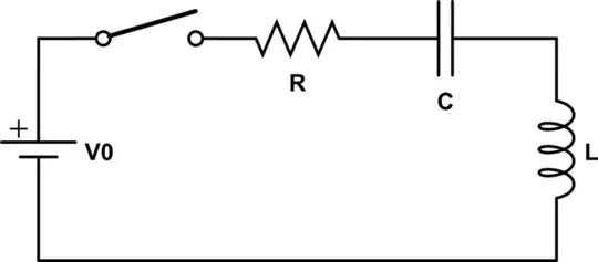

In this video, Lewin more clearly expresses his objection to formulating the problem in a way that reflects KVL. For this circuit:
schematic
Lewin shows that, starting at the bottom left corner and moving clockwise, the closed loop integral of \$\overrightarrow{E}.\overrightarrow{dl}\$ is as follows (note that no term is shown for the inductor because it is assumed to be ideal, ie, superconducting):
\$ \oint \overrightarrow{E}.\overrightarrow{dl} = -V_{0} + IR + \frac{Q}{C}\$
Because of these two identities:
\$\oint \overrightarrow{E}.\overrightarrow{dl} = -\frac{d\Phi_{B} }{dt}\$
\$-\frac{d\Phi_{B} }{dt} = -L\frac{dI}{dt}\$
We can describe the circuit using this equation:
\$-V_{0} + IR + \frac{Q}{C} = -L\frac{dI}{dt} \$
If we wanted to get something that resembles KVL, we can simply move the term that describes VL to the other side of the equation:
\$-V_{0} + IR + \frac{Q}{C} + L\frac{dI}{dt} = 0\$
Of this latter form, Lewin says moving the inductance term to the left "doesn't make the equation wrong, but the physics stinks!" because we now neither side of the equation wholly represents \$ \oint \overrightarrow{E}.\overrightarrow{dl}\$.
There cannot be "bad" probing in this situation, because there is no uniquely right, "correct" way to probe. Different arrangements of the probe wires will give different results, and those results need to be interpreted. The measuring device, together with its two probe wires form part of a loop. Any path in the circuit under test between the test points forms another part of a loop. Together, the partial loop containing the measurement device, and the partial loop containing the part of the circuit under test, make a whole loop. According to KVL, the sum of all the EMFs in that loop equals the sum of all the IR voltage drops in that loop. Thus, the voltage across the measurement device is equal to the sum of all the EMFs minus the sum of all the IR voltage drops other than the measurement device itself.
[Note, that since a measurement device (in a fixed configuration) will report its measurement in one given way, it should not matter which path within the circuit under test we choose between the test points to solve the KVL equation.]
One must account for the EMFs induced in the wires. It doesn't matter how we draw the schematic. In some cases, it may be more convenient to include four inductors -- one for each wire segment between a resistor and a test point. Or, we can omit the inductor symbols, as long as it is clear in context that there is a time-varying magnetic field, and that we need to take into consideration the EMFs induced in the wire segments when performing circuit analysis. Context, context, context. Just remember that one way or another, the EMF induced in the wires must be accounted for.
That depends on how you frame KVL. I think it's safe to say that one should assume that it's defined for a uniform magnetic field, or possibly that it's defined in a magical world where lines on a page are actually perfect conductors with no resistance and neither magnetic or electrostatic coupling to other lines on the same or other pages.
Note that I am not poo-pooing KVL -- but it is limited to theoretical explorations of ideal circuits. You should always have in mind how your real circuits are going to differ from the ideal representation in your schematic.
That's an opinion question. "Right" depends on what you're trying to find out, or what you're trying to prove.

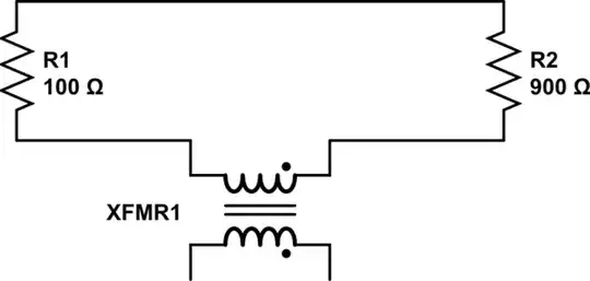

As drawn in the upper diagram -- yes. But as soon as you put that coil in there, you're adding elements to the schematic that don't fit with the classical assumptions of schematics. You are, in fact, implicitly breaking a classical assumption of schematics: that you can move components around arbitrarily as long as the lines stay connected. By drawing that coil in there you're taking a perfectly good schematic diagram and turning it into a woefully under-specified mechanical drawing.
I believe that the second drawing will let you accurately calculate voltages and currents in the resistors, but to accurately represent the effect on the voltmeters you'd need two more mutual inductances, between the coil and the resistor loop and the leads of the meters.
