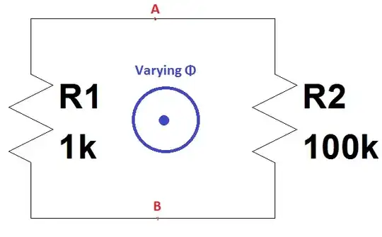

I don't know if this particular circuit/loop is covered in another question but I stumbled upon a video where a peculiar consequence occurs for the following circuit:
For the above circuit loop according to Faraday's law of induction one can write:
EMF = -dΦ/dt
And from the basic electric circuit theory for the current one can also write:
I = EMF/(R1+R2)
But since the same current passes through the resistors(KCL), something peculiar happens here.
Imagine the magnetic flux Φ starts increasing with a constant slope(which means EMF=-dΦ/dt is a constant); and during this time if we observe the voltage V1 across R1 by a scope between the point A and B, according to the logic the voltage across the points A and B would be current times the resistance which is I×1k Volt.
On the other hand, if we observe the voltage V2 across R2 by another scope between the point A and B, according to the logic the voltage across the points A and B would be again current times the resistance which is I×100k Volt with reverse polarity because of the reverse current direction.
Which yields: |V1| ≠ |V2| which are measured between the same points A and B at the same time.
How could this contradiction be explained?

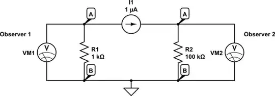

I guess the below circuit can be equivalent to what the professor says(?):
schematic
Only in this case what he makes sense.. Observer 1 and Observer 2 will observe very different voltages across the same nodes A and B at the same time. I couldn't find another model to make it fit this into his explanation. Like a current source which also is a short as component(because in real there is no current source both two node A above are the same points physically in this case).

The wrong assumption is that any point on the wires 'A' and 'B' are equivalent and that they constitute discrete "nodes".
If you have a straight wire segment in a changing magnetic field, there will be a voltage gradient along the wire. This doesn't result in a current flow, because the EMF of the magnetic field is "holding" the charges and keeping them from redistributing to balance the voltage.
Basically, the simple forms of KVL only applies when there is no EMF.

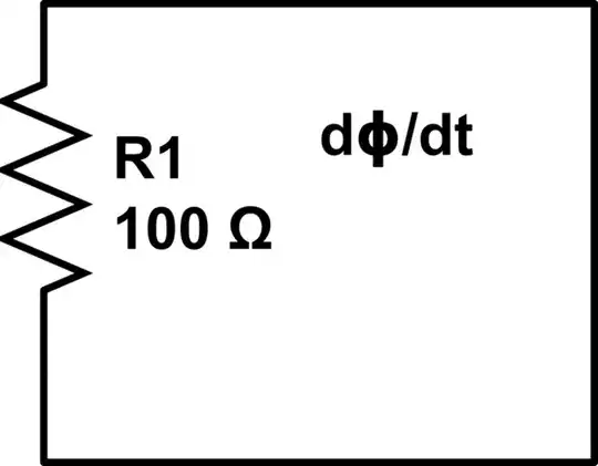

You can actually see the same problem with an even simpler circuit:
schematic
The EMF induces a current, and the the current generates a voltage drop across R1, but those are the same node!. Again, there is a voltage gradient across the wire connecting the two terminals of R1 in order to make everything work right.

It's no contracdiction at all.
KVL and KCL are not very fundamental laws of physics; they follow from more general and more fundamental Maxwell's Equations only if certain preconditions are given.
One of those preconditions is
\$\frac{d\Phi}{dt} = 0\$ outside of circuit elements
Its part of the lumped circuit abstraction, which must be satisfied if you want to use KVL or KCL.
Since this condition is not satisfied in your case there is absolutely no reason to assume e.g. that the sum of voltages in the loop must be 0.
If you want to analyze a circuit that does not satisfy the lumped circuit model you have to fall back to the more fundamental laws given by Maxwell's Equations.

  • Please see my Edit 2. What do you think? I took KCL valid by using a current source which also is a short. – user16307 Apr 10 '18 at 16:54
  • $A_{left}$ and $A_{right}$ are not the same nodes. So no reason to wonder why voltages across resistors are not the same. Current source is not a short; voltage across current source is not 0. – Curd Apr 10 '18 at 17:59
  • I already mentioned that in my edit. It acts as a current source and a short at the same time. Special kind of current source just to model this scenario. Because current is induced by the magnetic field the current source does not exist itself but "its effect" exists. Anyway.. – user16307 Apr 10 '18 at 18:39
  • You can't just postulate that your current source is also a short. A short would mean that it is a voltage source (of 0V) at the same time. Either it's a current source or a voltage source. – Curd Apr 10 '18 at 18:54
  • Who says I cant? I just introduced a new component model. – user16307 Apr 10 '18 at 18:55
  • By definition a current source provides exact that voltage which will cause its nominal current going through it. By definition a voltage source provides exact that current which will cause its nominal voltage across it. Don't you see the contradiction if you postulate a component that is both in one? – Curd Apr 10 '18 at 19:00
  • Dude this is not a current source you are wasting your time. Just a model and it works in sim as well. Im not gonna try to convince you are repeating yourself. A current source which is also a short but not current source call it X. It is only for this example model. – user16307 Apr 10 '18 at 19:01
  • If you know everything better why do you ask a question in the first place?!?! – Curd Apr 10 '18 at 19:05
  • Good question. I dont know the answer in depth in physics wise. The edit 2 is just a kind of model I made was just theoretical just to make sense Dr Lewin's argument in a lumped model. You can make any theoretical model similar to this. But there are some answers here which do not agree his experiment. The model I added was not really the question. The question was whether he is right aka we observe different voltages. – user16307 Apr 10 '18 at 19:09
  • Model is just a byproduct, thats why I dont care if it obeys rules of it is just a imaginary model. Any other model could be done as well. I just wanted to make current circulating caused by a changing magnetic field. But I still not sure whether his experiment is valid. Some wrote he is cheating. – user16307 Apr 10 '18 at 19:11
  • @user16307, any model which acts as a current source and a short at the same time invalidates KVL automatically. Probably KCL also. I don't think you are arguing in good faith. You are acting the equivalent of a troll. Maybe that is not your intent, but that is the result. – user57037 Apr 11 '18 at 16:25

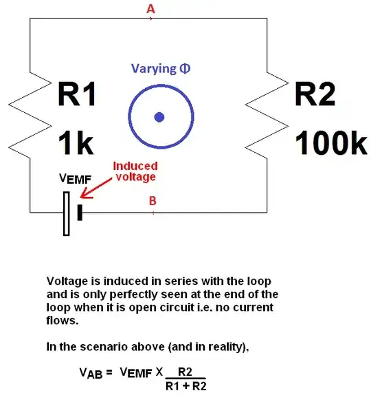

The induced EMF is in series with both R1 and R2 and not \$V_{AB}\$ as shown in your picture.
Voltage is induced into the loop in series with the loop and not across the end terminals (unless those terminals are open circuit). This will force a current through the resistors but you also need to take into account that the loop has inductance and it will form an extra impedance in series with those resistors and reduce the current a bit more.
The inductance is difficult to calculate because it depends on the "thing" generating the flux (maybe another coil) and how closely those coils couple. Anyway, ignoring the inductance effects as they are somewhat trivial, here is the bigger picture: -
The mistake in the question is that it is assumed that \$V_{AB}\$ is the induced voltage (but it isn't).

    Correct. The simple model as given in the question does not account for the inductance of the conductive loop. Without this inductance, the current would approach infinity. I found this article: "Perfectly conducting loop of wire moving through a uniform and stationary magnetic field" at http://www.scielo.br/scielo.php?script=sci_arttext&pid=S1806-11172013000100009 – Bart Jun 06 '17 at 13:00

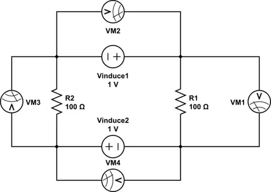

The wire between the resistors acts as a voltage source. If you keep the voltage source in KVL equation, it will perfectly hold together. If you ignore the source and just add up the voltage across the resistors, KVL may appear to fail but actually you aren't applying it correctly.
The following circuit is the equivalent to your two resistor circuit when a changing magnetic field is applied.
If you add VM1, VM2, VM3 and VM4, they will add up to zero.
RIP Kirchhoff!!
