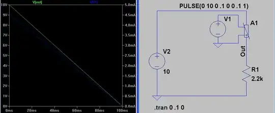

Use the SpecialFunctions/Varistor.asy component with a time-varying voltage source
Screenshot

  • +1 Thanks, Its not how I remember doing it but It should do the trick. I won't mark this approved just yet I like to see if anyone has any alternatives..(although it doesn't look likely...) – volting Jul 20 '10 at 15:29
    There are plenty of alternatives - You could use a transistor with a known Rds characteristic, and change the gate voltage from 0 to saturation, or just put in a voltage or current source and ramp through the voltage or current range that you want to establish across your resistor. The varistor, however, is the controllable resistor you asked for. – Kevin Vermeer Jul 20 '10 at 16:35
  • Sure.. but if my memory serves me correctly(which it probably doesn't) it is possible to do it with a regular resistor + some simulation command, which would be more intuitive and straight forward. Anyway Thanks again for the suggestions – volting Jul 20 '10 at 18:19
  • Use the source, Luke! Open up the varistor model definition and subcircuit, and figure out what it does - The SPICE commands should be in there somewhere. This document: http://ltspice.linear.com/software/scad3.pdf should help you. – Kevin Vermeer Jul 20 '10 at 19:20
  • Point taken! It came to me... what I used before was a parametric sweep – volting Jul 20 '10 at 20:22
  • This solution doesn't appear to set the resistance, rather it sets the voltage drop over it. It doesn't seem to be any different to just placing a voltage source in place of the varistor, except that the varistor will never drop more voltage than what is being supplied – JolonB Nov 26 '20 at 20:06
  • @JolonB Not true: it sets the threshold when the varistor starts conducting, and its conduction is given by the parameter Rclamp. The effective resistance will be Rclamp + V(+,-), e.g. with the default Rclamp=1 and a 3 V controlling voltage, the resistance will be 4 Ohms. It's easy to set up a current source with 1 A across a varistor, and let's say a voltage source as the control with SIN(1 1 1). Simulate with .TRAN 1 and you'll get a sine varying from 1 V to 3 V (2 Vpp + default Rclamp). – a concerned citizen Oct 19 '21 at 15:40

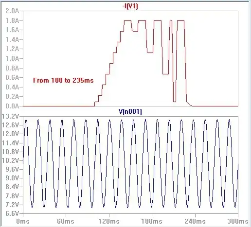

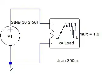

Using McHale's suggestion, I produced a Current Dummy xLoad to test power supplies and power circuits. Based on a PWL sequence, the Load sucks current from the power supply, no matter the voltage at the supply.
The PWL sequence specifies a ramp&shake profile that exercises the supply, so one could analyse the behavior of such supply, if it bounces, oscillate, ring, voltage recuperation time, etc.
The xLoad .asy file can be anything with two connections, since it behaves like a dynamic resistor that change its value based on the PWL values AND the voltage applied at the Load inputs. You can apply a 10Vdc with a ripple of 9V and the Load will adapt its dynamic resistor so it follows the current profile from the PWL.
The xLoad has only one parameter, "mult". This parameter allows the user to change the maximum current from the PWL profile, so, mult=1 will use a profile that will suck maximum of 1A from the supply, mult=4.2 will suck a maximum of 4.2A. Your xload.asy must have a visible attribute "mult=1", so the xLoad will work, and you will be able to change the attribute at any time.
The xLoad uses a small capacitor to round very sharp edges that can simulate very high frequencies and rings, what doesn't happen in real life, so all the corners are a little rounded. If you want to change or eliminate this feature, just change the value of C1 from 10n or even eliminate that line. The feature is just a RC filter, R2 and C1, other way to change the filter is changing the value or R2, just don't delete such line, xLoad will not work without R2, you can change its value to zero ohms to eliminate completely the filter, even so I don't know why you will want to have MegaHertz sharp corners.

The simple .asc simulation with the symbol I made, and the plot planes showing current and supply rippled voltage below. Note that based on the PWL timmings, xLoad starts running at 100ms and finished at 235ms. You can change those timings at the PWL values inside the SUB.
