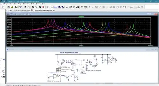

Here in these LTSpice snap shots I modeled the popular MFJ regenerative receiver circuit so that I could add an AGC circuit to the audio later on. I have the tuning coil L1 with an inductance value stated as {lt) and C7 capacitance is stated as {ct) these two components will then be tuned in an AC Anlysis Plot with various component values that the software will vary and plot.
To do this you will write 4 seperate spice directives as numbered below, do not add the number at the beginning of these directives
  1. .param lt = 14u
  2. .step param lt list 80n 410n 1.41u 4.71u 14.71u
  3. .param ct = 28p
  4. .step param ct list 5p 28p 56p
The .param describes the value of the coil and capacitor to begin with, the coil is 14 uH and the tuning capacitor is 28 pF. The .step directive tells the software to plot values of inductance for L1 from 14.7 uH down to 80 nH. And the .step directive for C7 tells the software to plot values for C7 from 56 pF down to 5 pF.
The measurement will be taken from a circuit node that you name " tune " as the Net Name with no port type but you can select " output " if you want.
When you run the AC Analysis it will take about a minute or so to plot all of this. When it is done, you then click the circuit node " tune " and the plot will appear as shown in the Snap Shot 2 posted here. All of these resonant tuning plots will be done at once. So have fun with this I have!
P.S. I know that this is not time or temperature related but I am thinking that perhaps you can do something with time and temperature parameters and steps. Someone might be able then to use this from this vantage of view.
Snap shot 1 Snap Shot 2
