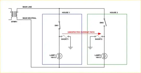

3. With a floating system it is possible to have a short between both in-house and neighboring systems via the ground path as shown below. Turning a light on in your house can cause a light to go on in your neighbors house too. This characteristic is highly unpredictable.

    Your point 3 (with diagram) assumes that both neighbors have an actual metal rod going deep into the ground — wired to the metal cases etc. The argument fails where either of the neighbors do not have such a thing (which would make sense to if they advocate not tying anything to the actual earth, let alone the neutral). Note that lightning protection could be a separate installation not attached to the house/circuit at all. – Greendrake Mar 03 '21 at 10:17
    @Greendrake I don't like point 3 because why on earth would a neighbour have an appliance connected between where their neutral is grounded and the transformer anyway? Also point 1 doesn't make sense, the reference is still basically the neutral because ground has most of the resistance, I think it would only reduce the voltage measured at that point in an extremely miniscule manner – Lewis Kelsey Apr 27 '21 at 12:22

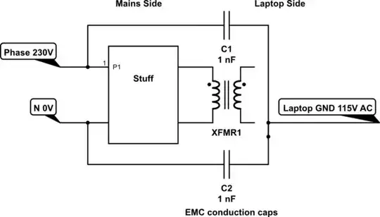

Besides inadvertent grounding through some device there is also leakage current to ground, through capacitors. Your computer has a galvanically separated power supply, so it is safe to touch. But there is a C between the primary ground and the secondary to short-circuit the EMI of the SMPS. If the ground is not connected and you touch the case then the 50-60 Hz current through that C (and the C of the transformer) gives you a tingle. Connect 10 such devices with 10 Cs together without explicitly grounding any of them and that tingle becomes a shock. That's why you should use an outlet with ground for modern electronic devices. [edit: added schematic from another thread Henry Crun]

  • Thanks for explaining the tingle I got as a teenager caressing my shiny new stereo system receiver! Ah, the good old days. –  Mar 16 '18 at 17:26
  • There is also a (significant) capacitance from primary -> secondary of overlap wound transformers. Low leakage transformers have side-by-side wound bobbins, with thick bobbin plastic between windings. Alternatively, Farady shields are a grounded foil between the primary and secondary. (so the C is to ground) – Henry Crun Mar 16 '18 at 21:50

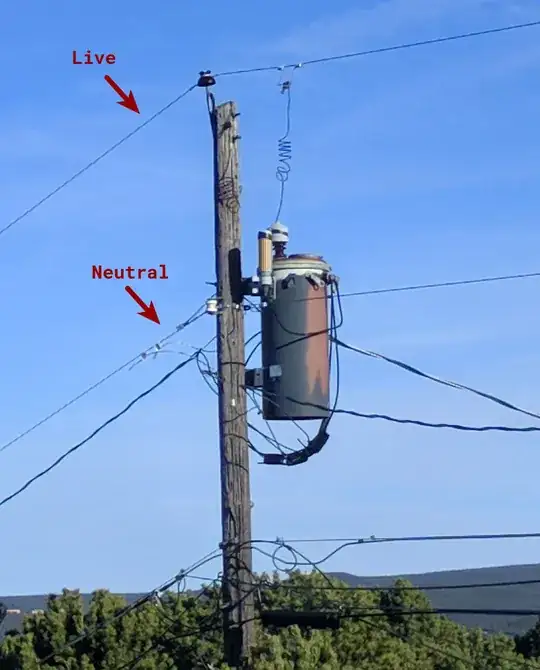

This power pole outside my house shows an advantage of having the neutral wire grounded. The live wire is located by itself at the highest and safest location, while the neutral wire is further down on the pole.
