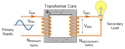

1. The transformer
Isolation is very easy using magnetic coupling. Consider the GM Magnecharge EV charging system. The entire paddle was lined with plastic. The inside of the slot was entirely lined with plastic. There were no metal surfaces at all. Yet, it could charge the car at 7kW or 50kW.
So this type of magnetic isolation is very easy. Simply have a "primary winding" around an iron core attached to AC mains, and at the other end of the core, a "secondary winding" at a much lower voltage. Power gets between them as magnetic flux which has no voltage at all. And as demonstrated by the EV1 charge paddle, it doesn't even need to be continuous iron! So a seventh insulation gap could be added.
The winding wires have insulation individually (mostly to insulate them from each other to keep the winding from shorting). Then the entire winding is wrapped or put in a plastic cage. Then the iron core itself is dipped in enamel. Just within this transformer, six insulations would have to fail:
  • primary winding wire insulation
  • primary wrapping or cage
  • transformer enamel at primary
  • tranformer enamel at secondary
  • secondary wrapping or cage
  • secondary winding wire insulation
Granted, an extreme electrical spike could blow a hole through all three in one place, but it would have to do that twice in two different places. It will get stopped at the iron core, because.....
