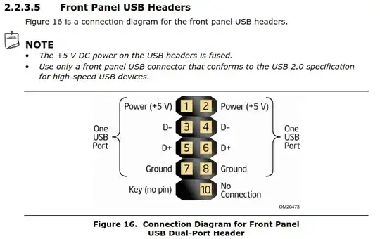

There is a de facto standard that motherboard manufacturers use for front-panel USB: 0.1-in male headers, often in pairs in a 5x2 format with a key, sometimes 4x1 or 5x1. Consequently case companies have made USB-A adaptors with that matching pinout. The only real advantage of using this pinout is that you could get standard parts for testing, debugging, soak-testing and so on.
This is from Intel's DN2800MT, a very widely-used flat Mini ITX motherboard, very commonly used as an embedded motherboard. enter image description here From DN2800MT manual
Note that pin 10 is sometimes used for things like LEDs (see same document, fig 17).
Dell uses the same pinout for all the motherboards I looked at. (5x2, key on 9). Other adaptors have been on 5x1 and 4x1, for single USB ports.

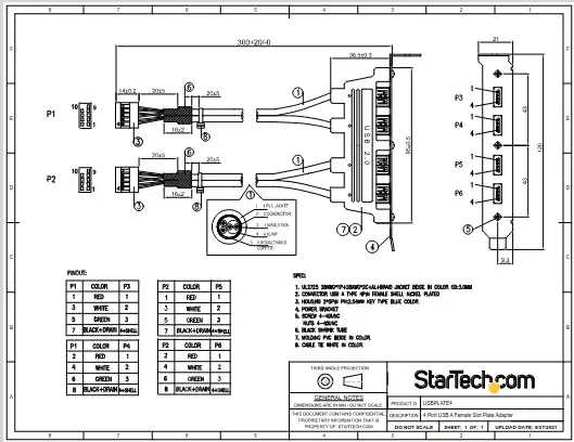

Casing and cabling companies offer all kinds of adaptors, here is just one enter image description here
Startech USBPLATE4 drawing

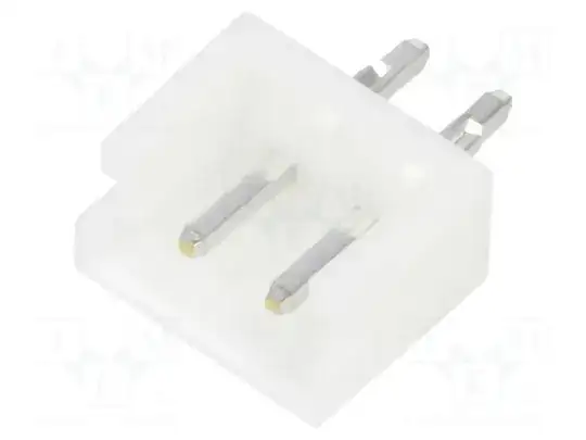

USB2, especially over short distances, is pretty forgiving. There should really be no downside in using just any 2-pin (if you only need the data pins) or 4 pins (if you need +VUSB and GND as well) connector of your choice. For cabling within low-density devices, that's typically something like the ubiquitous JST 2.5mm pitch self-locking pin sockets.
JST pin header
You'd typically crimp the cables into the female counterparts to this yourself (or order the cables custom) to get them in the exact length you'll need.

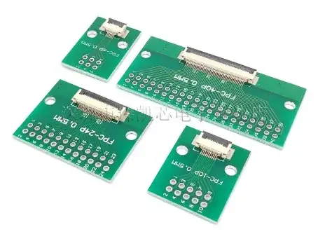

Many laptops today use flat cables to do interconnect between mainboard and separate peripheral mini-boards with USB connectors. The flat cables can be designed to have shield/return ground (copper/aluminum planes) on both sides of the cable,
and ZIF connectors are used (image from Ali Express).
