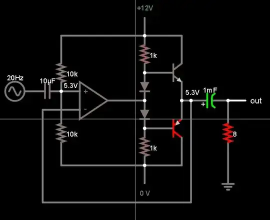

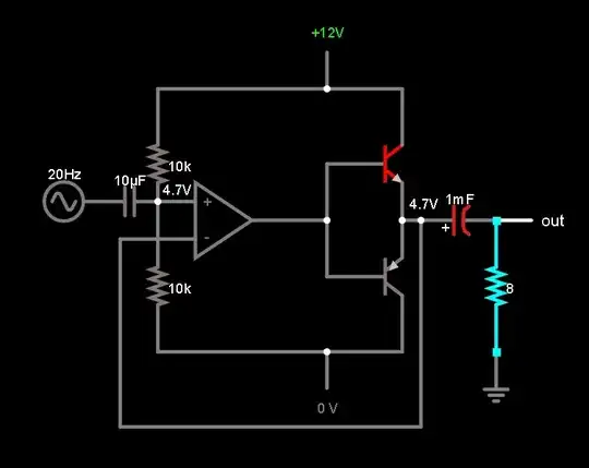

I built and simulated this BJT current buffer for an opamp based on examples I found in various places online: enter image description here
Link to simulation of above schematic
It simulates fine, but I am pretty sure it will not work as drawn in practice. For one thing, any actual opamp cannot swing instantaneously through the 1.4V crossover region without some form of distortion. I'm sure there are other things as well.
What alterations would need to be done to make this a functional circuit in practice?

EDIT: If I diode-bias the bases like this: will I get suitable audio performance? It doesn't need to be exactly hi-fi quality, just not noticeably distorted. With Diode Biasing

    Seems like a quite typical class B output amplifier to me. Using diodes to bias your transistors is common to improve the crossover distortion (called class AB) – Joren Vaes Sep 19 '17 at 17:37
  • Will diode bias work without any bias current through them? – Frosty Sep 19 '17 at 17:43
  • No, you need to send some current through them. – Joren Vaes Sep 19 '17 at 17:45

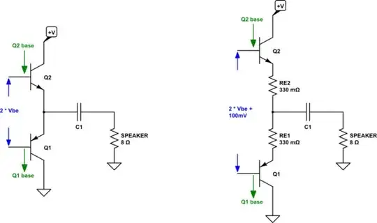

Let's start at the given output driver topology:
schematic
On the left is the basic idea, but it is worth some discussion already.
\$C_1\$ exists, in part, because a speaker is a complicated device and doesn't entirely enjoy an average DC current flowing through it and because you aren't using a bipolar power supply. So \$C_1\$ exists, in small part, to block DC currents. In use, it will soon charge up to an appropriate average voltage across it so that the average current centers around zero. The speaker is complex, but for these purposes (low power, etc), other than justifying an output capacitor, we can just lump it out the way, as you did, and move on.
To avoid most of the cross-over distortion, you want both \$Q_1\$ and \$Q_2\$ to always be (close to) active. So as an initial guess, you probably want two \$V_{BE}\$ separating the base voltages between the two BJTs.
Now, look to the right side. I've added some emitter degeneration (which helps for several reasons.) A lot has been written about this and I've read some. I won't try and replace the discussions by professionals in this area. But suffice it that if you set the voltage drop across these resistors to around \$60\:\textrm{mV}\$ or so at the expected RMS current, you are close enough to optimal for hobbyist work. (A professional producing a commercial product would anguish over this whole single detail a lot more than I'm going to.) Given that you want \$\frac{1}{4}\:\textrm{W}\$ into \$8\:\Omega\$, this means you have \$\approx 180\:\textrm{mA}_\textrm{RMS}\$. From this, I get pretty close to the resistor values you see there on the right side. All this really means is that you might need just a little bit more voltage between the bases. Best to plan on making some room for it, though.
At this point the question is how are you going to actually drive those two BJTs. The simple approach is to just use "diodes" somehow. Of course, if you go that way, you will need to supply them enough current that they develop the voltage you want to have. It would be better to use a constant current because that would provide a nearly constant voltage across them (assuming their temperature doesn't drift around a lot.)

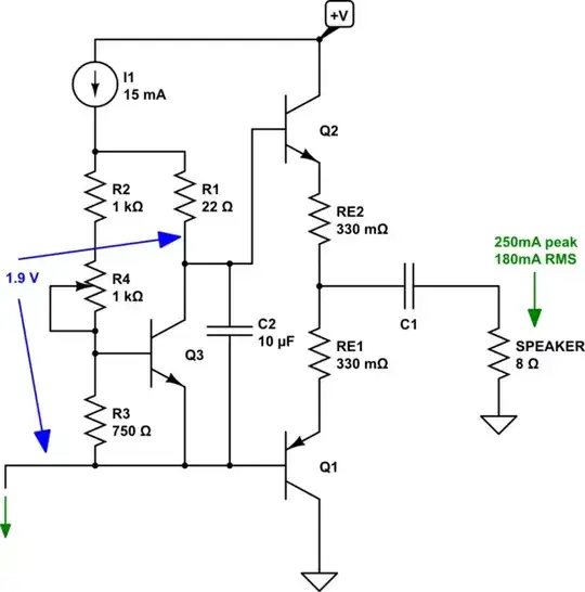

But since you want this as a learning lesson, the next thing to consider is an adjustable \$V_{BE}\$ multiplier. These are worth learning about and they are not expensive or difficult.
schematic
simulate this circuit
I've designed the above \$V_{BE}\$ multiplier based upon the idea that there will be something like \$\frac{250\:\textrm{mA}}{\beta=100}=2.5\:\textrm{mA}\$ peak base drive current needed for \$Q_1\$ or \$Q_2\$. The \$15\:\textrm{mA}\$ current source at the top represents something we need to worry about, later. For now, just assume it exists. The unconnected lead at the bottom will have to sink this current somehow (or the portion of it that isn't used for base drive, anyway.) I decided to pick \$14\:\textrm{mA}\$ as the "nominal" design current for the multiplier.
Out of this \$14\:\textrm{mA}\$, I decided to assume \$1\:\textrm{mA}\$ for the base resistor divider branch of the \$V_{BE}\$ multiplier, leaving the collector current to be \$13\pm 1.5\:\textrm{mA}\$, depending on instantaneous circumstances. With that level of collector current, I decided to estimate \$V_{BE}\approx 750\:\textrm{mV}\$ for \$Q_3\$. So \$R_3=\frac{750\:\textrm{mV}}{1\:\textrm{mA}}=750\:\Omega\$. I want the sum of \$R_2\$ and \$R_4\$ to then be \$1150\:\Omega\$, discounting an error due to the base current for \$Q_3\$. I've added a standard \$1\:\textrm{k}\Omega\$ potentiometer, along with a nominal value for \$R_2\$ that will provide a settable voltage range of from about \$1.3\:\textrm{V}\$ to about \$2.3\:\textrm{V}\$. That covers the desired value and provides some adjustment range.
By the way, the \$1.9\:\textrm{V}\$ isn't cast in concrete. The actual value you want will vary a bit because discrete BJTs for \$Q_1\$ and \$Q_2\$ vary a bit. Make it too big and you will waste unnecessary power. Make it too small and you will hear the cross-over distortion.
\$R_1\$ is there to correct for the incremental resistance and the Early Effect. I won't belabor how that gets calculated, unless you ask. That value might be "good" somewhere between \$10\:\Omega\$ to about \$33\:\Omega\$.
Now you need to supply a current source. This can be done with a current mirror. But a much "cheaper" technique uses bootstrapping from \$C_1\$. The new arrangement is:
schematic
There's about \$1\:\textrm{V}\$ between the base of \$Q_2\$ and its emitter (plus the little \$RE_2\$ resistor.) And since the average voltage across your speaker is \$0\:\textrm{V}\$, there will be about \$6\:\textrm{V}-1\:\textrm{V}=5\:\textrm{V}\$ across \$R_5\$. With a signal applied, \$C_1\$'s steady state voltage of about \$6\:\textrm{V}\$ still applies and as the base of \$Q_2\$ moves upward, so will its emitter (it's an emitter-follower, after all.) So \$C_1\$ will be hauled up, as well. The same logic applies for downward signal directions, too. So the voltage across \$R_5\$ remains rather unusually constant regardless of the signal changes. Which is all we actually need to create a cheap current source out of \$R_5\$.
I've computed the value as \$R_5=\frac{5\:\textrm{V}}{15\:\textrm{mA}}\approx 330\:\Omega\$.

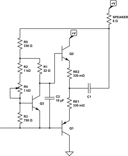

The output of your NE5532 isn't guaranteed to be more than about \$10\:\textrm{mA}\$ (worst case and into a dead short.) So let's reduce the current source above to about \$6\:\textrm{mA}\$ ... and plan on letting that work out. (Won't be nearly so stiff, but probably acceptable for your case?)
schematic
(I adjusted \$R_1\$, \$R_2\$, and \$R_3\$ for the lower collector current.) Here, you will need to set up a voltage divider for the mid-point voltage of \$6\:\textrm{V}\$, using \$R_6\$ and \$R_7\$. Do what you think is appropriate, there. It isn't difficult, though. Then you need to decide on the gain you want. I've provided allowances here with \$R_8\$ and \$R_9\$, so you can make some decisions here. \$C_3\$ is there for your convenience, if you need it, as that is the path for your single-ended audio input.
That's about it. Make \$C_1\$ huge, though. Add bypass capacitors where you think appropriate. Build that and play with the value of \$R_4\$. It should be about right with the wiper in the mid-range position.
Oh, and keep in mind that the NE5532 output swing range isn't all that much. Luckily, I think it will be fine for \$\frac{1}{4}\:\textrm{W}\$, which doesn't require more than \$\pm 2\:\textrm{V}\$ swing. It's output only needs to get within about \$3\:\textrm{V}\$ of ground. And it probably can do that.

Yes it will work.
Will it be any good? Nope.
The problem with this circuit is around the "zero crossings" which are not at 0 Volt in your circuit but around 6 V since you're using a 12 V supply.
The problem occurs when the direction of the output current needs to change. Then the transistor which had been supplying current must be switched off and the other transistor must be switched on.
At the switching point there's a moment when both transistors are off and this results in crossover distortion.
The solution is to take care that some current always flows through both transistors. A class AB stage has this.

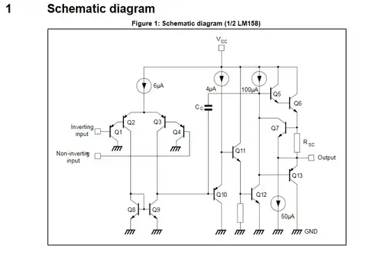

Indeed it can't. The rate at which the opamp output can charge is the slew rate. For example the LM358 has a slew rate of about 0.5V/us, so it would take about 3 microseconds to swing through the crossover region.
Many opamps internally suffer from crossover distortion as well, which should be clear when you look at the equivalent schematic and see a class B amplifier for the output
on the left, class B amplifier with short-to-ground protection and 50uA offset Darlington NPN Q5/Q6 and PNP Q13 form a push pull class B amplifier. Q7 provides short-to-ground protection. The resulting crossover zone is about 2 volts.
So the choice of whether to eliminate the crossover distortion by using a more complex design depends on whether the crossover distortion affects the signal quality. For example, if the crossover distortion lasts 3 microseconds and the worst case signal is a constant 20kHz (25 us between zero crossings), it could experience distortion of 12%.
