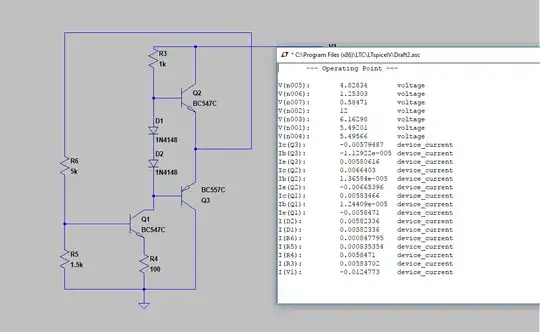

I have been designing the same basic AB amplifier, trying to really understand all the intricacies of currents, voltages, and power flowing throughout the circuit. I have ignored all signal inputs for now as I am focusing on understanding the biasing with feedback in this circuit. The final circuit has capacitors, I have not included them for simplicity. I have built the circuit with appropriate caps, etc. The circuit works, but the transistors get very hot under quiescent conditions. (Have not yet included emitter resistors R1 and R2, which might explain the currents).

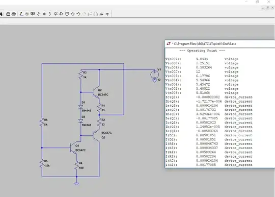

Modeling this circuit in spice, there is a 7.6mA total current supplied by V1. The current flowing through the R3-D1-D2-R4 is 5.8mA and the current flowing through the collector of Q2 is 1.8mA. This makes sense with KCL at node 1. The voltage at the base of Q2 is 6.2 volts. Assuming 0.7 Vbe, the emitter voltage at Q2 will be 5.5 volts. According to spice, the voltage at node 2 is 5.48 volts, or 20mV dropped across R1. This won't work since 1.8mA is flowing through the Q2 collector (0.020/33 = 0.61mA), so am I missing how Q3 influences this?
Is something in the circuit causing a voltage drop across R3 of 5.8 V, or is something in the circuit causing 5.8 mA of current to flow through R3? It kind of seems like a chicken v. egg. I don't know what is affecting what in the circuit. Also, what is causing the 1.8mA through Q2? If the voltage at the emitter of Q1 was known, the base voltage at Q1 could be known and also the voltage at node 2 due to the bias network.
What makes Q1's emitter voltage 0.5V as reported by Spice? The collector voltage at Q1 is the same as the base voltage of Q3, which is two diode drops below the base of Q2. But, I am then back to my first question.
It seems like there are a lot of unknowns, and if you can figure one of them out, the rest falls in place utilizing all the basic circuit analysis tools. I have always struggled with where to start on a circuit like this though.
Finally, below is a picture of my Spice analysis.
Edit: I just simulated the same circuit without R1 and R2 and the currents do go way up (see below Spice analysis picture), which probably explains the heat. I think my questions are still valid though.

    "Assuming Vbe=0.7V" is one problem. –  Sep 24 '17 at 13:49
  • Ok. I understand that. But regardless, i think that is how the spice analysis worked out. – nu77p01nt3r Sep 24 '17 at 14:15

  • @jonk - that is a very well written article. I can see why i didnt find it originally, the title had to do with op amps, etc. I think i understand what you are saying, i guess in summary you have to assume something in the circuit, calculate everything, then tweak assumptions if needed. It seems like you should be able to calculate everything and not have to make assumptions, but maybe not. – nu77p01nt3r Sep 24 '17 at 19:51
  • @jonk- i am familiar with the LTP, was just focused on this part (VAS and output) and then i was hoping to keep adding and changing to make it better. – nu77p01nt3r Sep 24 '17 at 19:53
  • @nu77p01nt3r You could calculate everything from scratch, but the most significant problem is that BJTs vary a lot -- even within a batch. And also, exact calculations also involve LambertW and most folks aren't even familiar with it, anyway. (Look it up here and you will see me writing about how to apply it, if you really want to.) So you start out deciding where you want things to be, then you work out how much they might NOT be what you want. Then you work on how to minimize those problems. Etc. Iteration is the rule. – jonk Sep 24 '17 at 21:11
Chicken & egg is an accurate way to describe what happens in this circuit... or any circuit that is enclosed in a feedback loop.
Here, you have the operating point - and therefore the output voltage at node 2 determined by the node 2 voltage fed back through bias resistor R6 to the input of your amplifier. This overall feedback is negative because there is only one inverting stage, Q1. Most circuit analysis is performed based on achieving a specified output.
So, to begin, assume output voltage (node2) = 1/2 V1 = 6 volts. This will allow the maximum peak-to-peak output voltage swing under signal conditions.
Choose a quiescent emitter current for Q2; let's say 10 milliamps.
Calculate the voltage drop across R1 = 0.33 volts.
Calculate voltage at the base of Q2 = 6.0 + 0.7 + 0.33 = 7.03 volts.
Calculate the voltage drop across R3 = 12 - 7.03 = 4.97 volts.
Calculate current through R3 = 4.97V/1000 = 4.97 milliamps.
Calculate collector voltage of Q1 = 7.03 - 0.7 - 0.7 = 5.63 volts.
Calculate the emitter voltage of Q3 = 5.63 + 0.7 = 6.33 volts.
Calculate the voltage drop across R2 = 6.33 - 6.0 = 0.33 volts.
Calculate the current through R2 = 0.33 volts / 33 ohms = 10 milliamps.
We now know that Q2 and Q3 emitter currents are ~ equal.
Assume Q1, Q2 & Q3 beta = 500.
Calculate Q2 & Q3 base currents = 10 milliamps / 500 = 20 microamps.
Calculate Q1 collector current = 4.97 milliamps - 0.02 milliamps - 0.02 milliamps = 4.93 milliamps.
Calculate Q1 base current = 4.93 / 500 = 10 microamps.
Calculate Q1 emitter current = 4.93 milliamps + 0.01 milliamps = 4.94 milliamps.
Calculate voltage across R4 = 100 * 4.94 milliamps = 0.494 volts.
Calculate Q1 base voltage = 0.7 + 0.494 = 1.194 volts.
Calculate current through R5 = 1.194 volts / 1500 ohms = 0.796 milliamps.
Calculate current through R6 = (6 volts - 1.194 volts) / 5000 ohms = 961 microamps.
Now you could reiterate, knowing that about a milliamp of the 10 milliamp emitter current of Q2 is flowing out of "Node 2" back to the base of Q1. Q2 & Q3 are dissipating about 60 milliwatts each, which might be closer to Class AB+, but you can see that lowering the quiescent power dissipation in the output transistors is as simple as choosing a lower value for quiescent emitter current in Q2 and Q3.
In practice, the operating point is often set by a resistor in parallel with diodes D1 & D2.
Hope this helps. Have fun!

The way to solve a circuit with feedback via first-order hand calculations is to:
  1. break the feedback loop
  2. Assume the current at that point is negligible
  3. use the broken node as your input
  4. write the circuit equations based on that unknown input
  5. Equate input and output
  6. Solve for that unknown
  7. Verify your assumptions
Breaking the circuit at node 2 and assuming all diodes and transistor junctions at 0.6V (this will cause problems for the current through Q2 and Q3, but we can take care of that later):
  1. Calculate the current through the base of Q1 as a function of Vnode2
  2. Calculate the current through D1 and D2 as a function of Vnode2
  3. Calculate the voltage in the middle of D1 and D2 as a function of Vnode2
  4. As D1, D2, Q2. Q3, R1, & R2 have symmetry. Vnode2 will be equal to the voltage between D1 & D2.
  5. Now solve for the one unknown
This gives you a first approximation. Now you can find the actual current and verify how much it deviates from the initial assumption. Note that you could have incorporated this unknown current in the above procedure and you would have ended up with two equations with two unknowns.
As an aside, calculating the actual current through Q2, Q3 is tricky as it requires using the actual non-linear equations for Vbe. This results in transcendental equations.
